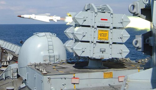

Worse was yet to come. Seawolf should have had a simple lightweight 4 box launcher which could fit where a Seacat had been. God alone knows why we had to have the manually loaded 6 box abortion.

Sea Wolf....on the basis of 2-3 AShM incoming, two interceptors per target. No time to reload as Attack coordinated to arrive at near simultaneous. Hence double ended systems.

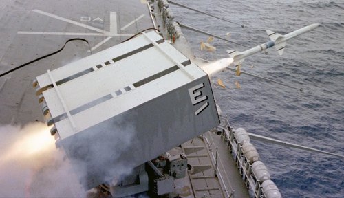

Can't be any worse than the plywood, manually loaded Sea Sparrow (500lb missile) launchers with manually slewed illuminators. (Okay, maybe not plywood but damn near as cheaply built.)
a-gunners-mate-mans-the-mark-115-sea-sparrow-fire-control-system-director-during-cb06da-1024.jpg

Type 22 had twelve ready to fire. A typical Sea Sparrow ship had nine ready to fire from its equally cumbersome launcher see attached.
