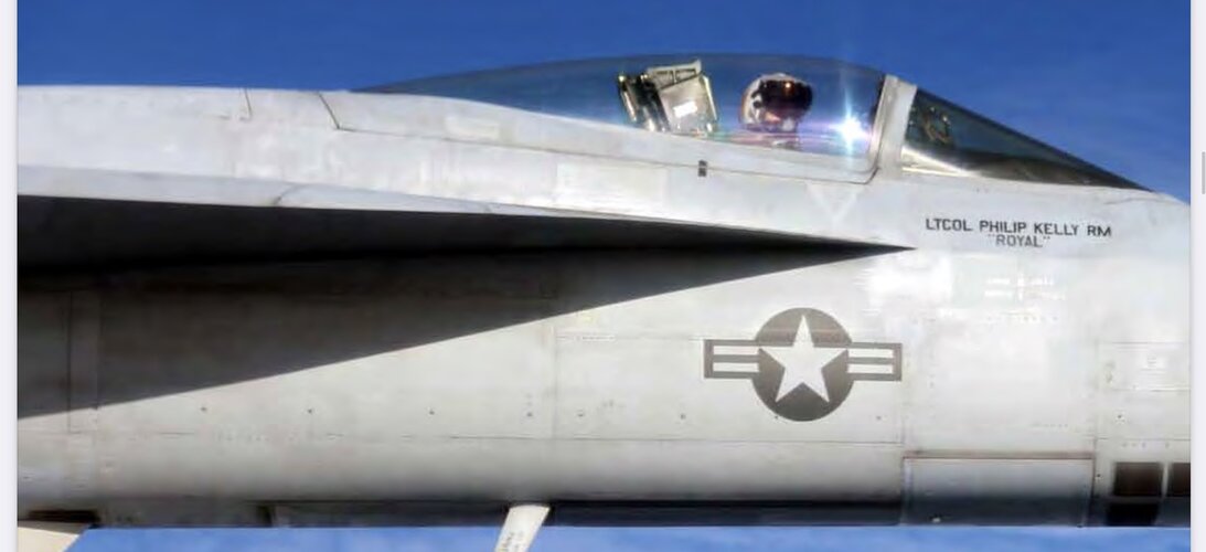

We have had exchange Fleet Air Arm pilots albeit Harrier pilots (both SHAR and GR/9) be it straight postings or work up to preparing us for QE operactions.
The oldest rank on this exchange was a Royal Marine Lt Col Phil Kelly who flew the Super Hornet from NAS Oceana as part of thr first cadre of Royal Navy FAA pilots to start learning the black art of CV aviation again after the demise of the Harrier. He was also the first Royal Marine pilot to qualify and fly the Sea Harrier. He became Carrier Strike Group Commander on the QE when it was commissioned.
A famous Commodore - and head of F-35 program for the UK and a great novelist Ade Orchard (I paid homage compliment on his book Joint Force Harrier at a military helicopter conference a few years back after his presentation).
cheers
