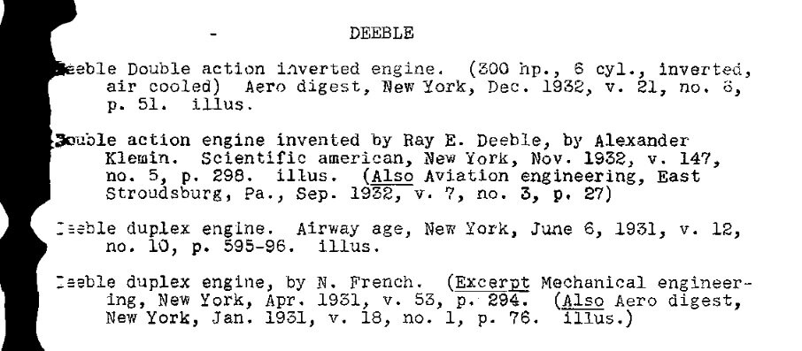

Ray E. Deeble's Duplex engine concept was being fairly widely written about in 1931 but that was a Long Beach, CA, project.
source: Bibliography of Aeronautics, Part 54 - Engines - By Manufacturer; Dec 1939; page 96
Is it possible that one of the smaller British producers had expressed an interest in Deeble's work? These engine had double-acting cylinders (rather like some locomotive engines of a half century earlier).
-- https://aeroenginesaz.com/en/brand_deeble
Thanks, I'll look into any possible licence agreements with UK manufacturers
