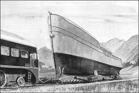

The 9-meter vehicle is illustrated in the book I referenced. It is *in* *sane,* a giant four-deck (tall enough for 5) rail-going Zeppelin-shaped monstrocity propelled by a pair of contra-rotating props at the back. A single car, not a train, 7000 horsepower, 250 km/h, 300 tons, 650 passengers.

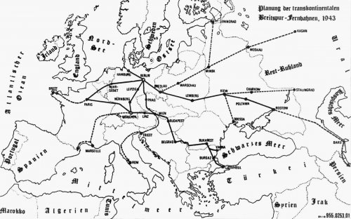

I'm well aware of that. You'll note for the most part, according to the map, the European routes avoid mountainous terrain. In South America, that is a little bit harder. You generally have a choice - mountains or rainforest. Not much else. Both have problems associated with them from a railway perspective. 3 Metres isn't, as I've mentioned, all that much larger than 4'9" standard gauge. Many routes couldn't be use but many others, could. The Russians showed that a really broad gauge could work - if you have room for it.
Fascinating and disturbing... thanks for the info.
