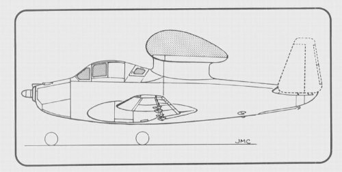

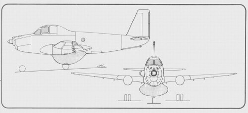

Yes, they did. As an answer to a request of the French Navy in 1957, Breguet came up with two
versions, both carrying an APS 20 radar, one in a ventral, the other in a dorsal radome. Drawings
from Jean Cuny, Docavia 6, "Les Avions Breguet (1940/1971)"

I only know, what Jean Cuny wrote:
The design office seems to have favoured the dorsal radome, and modification of an the Br.965 prototype or one of
the pre-series aircraft was offered, because the Navy wasn't willing to sacrifice one of the series aircraft. But the
project seems to have been abandoned at the beginning of the sixties, probably because of budget constraints.
Nevertheless, the Navy remained interested in AEW, because Dassault proposed a variant of the Spirale and Breguet
was asked to design specialised aircraft, leading to the Br. 123.
