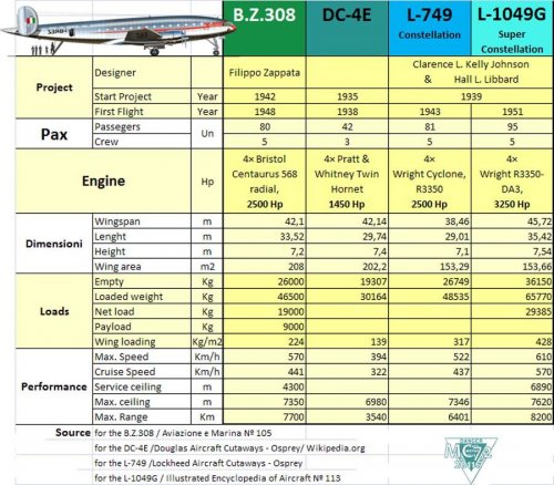

Taking into account the time line, I agree with Skybolt, the circumstances of that time, it may be that a perfect model plane could have influenced the drafts of BZ308 and Constellation, and this plane was the DC-4E, built in 1938 and also it, too, in a single copy, made ​​some service with United, but was underpowered and later sold to Japan.
The DC-4E is dimensionally quite similar to BZ308 as the Constellation, not to mention its solution tritail and tricycle; It is known that F. Zappa was in the United States and should have known well enough the characteristics of this Douglas aircraft , while the Constellation was still ahead in time.
Add a comparison table between the BZ308, DC4E and the first version of the Constellation, I think that the project of F. Zappata after the war and considering that the Super Constellation would appear in 1951 (after the Berlin airlift) ... was indeed a aircraft more than competent and with real technical possibilities for its inclusion in civil aviation.
