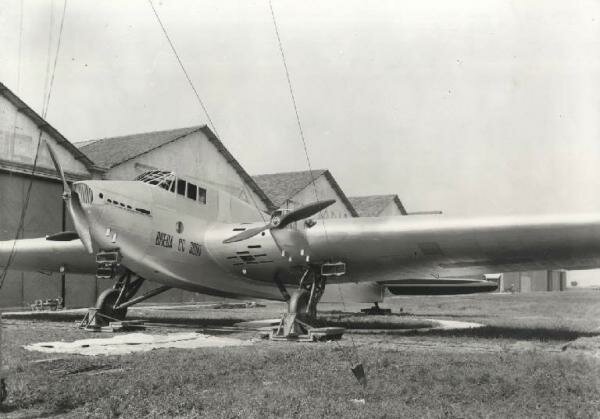

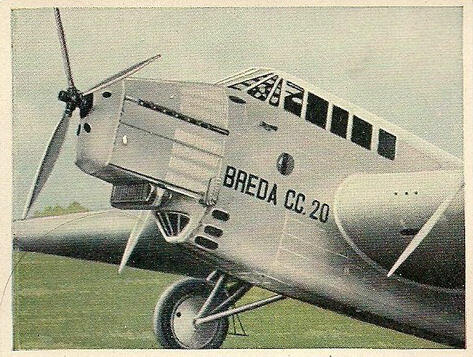

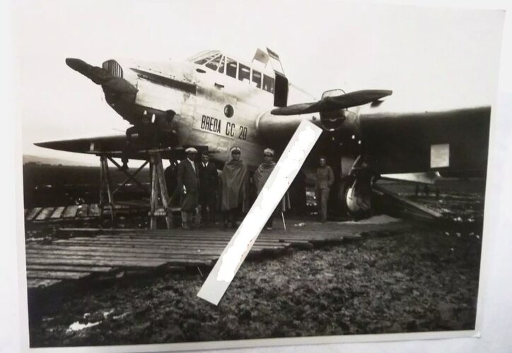

3. Pictures 1, 1a and 2, showed in its first form. It showed a radiator only beneath the engine and no turret.
1a gives also a good impression of the position of the bomb aimer.

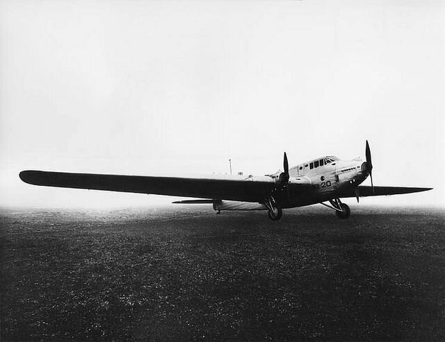

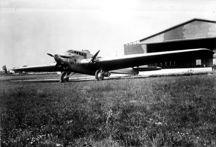

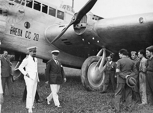

4. Picture 3 gives a good impression of the new place of the radiator. picture 4 shows the changes of the nose and 5 an all impression.

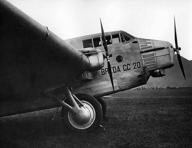

5. Pictures 6 and 7 are interresting. The nose is Breda CC 20 and the radiators are still the same, but the turrets are removed and the bottom fuselage is changed and the bomb aimer place removed.
