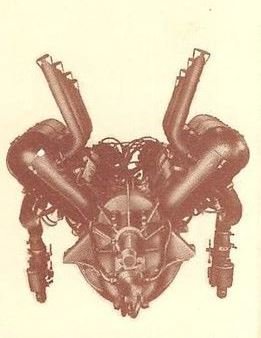

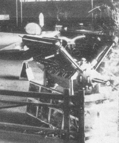

During my Breda inquiry I found that on the "Salone di Taliedo" of 1919 at the Breda stand there was an aer engine of 320 hp, further no details.
During the same period Breda build a few 80hp engines, which were used in some Breda-Pensuti's 2 seaters.
That small engine was mentioned in some articles as inline and V-8 engines, my opinion that both are wrong.
Looking at pictures of the two-seater Breda-Pensuti its to see that it was jot an inline and also not a V-8 but a V-4. I think that a V-8 with 80 hp was to heavy.
Until now I did not found more of both engine, but I think that the V-8 they mentioned was the 320 hp engine.
Who can help me with details, dimensions, pictures, drawings etc. etc. of both engines each small detail is welcome.
Quality is not important but what is on it.
Thanks
