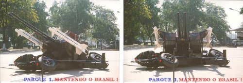

  • Towed Roland II: prototype towed launch unit for Roland II missiles. Canceled.

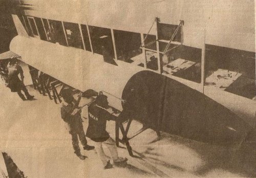

300-km SSM
An Avibras project began around 1986/1987 with the intention of creating a Brazilian missile matching the characteristics of the Scud-B SSM. It was to have inertial guidance and 300-km range. A full size mock up was built, but lack of interest canceled the project. The source also confirms the existence of a competing project by Engesa, the MB/EE-150 with 150-km range and a future 300-km variant.

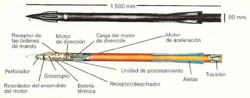

MAS-3.1
Shoulder launched SAM, to have been developed in collaboration with BAe (derivative of Thunderbolt) by Orbita. Canceled when Engesa bankrupted in 1993.
  • Guidance: Infra-red
    Length: 1.5-m
    Diameter: 6-cm
    Weight: 18.7-kg
    Max speed: Mach 3.9
    Range: 6-km

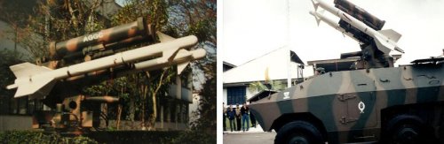

MAA-1
IR-guided AAM similar in design to Sidewinder. Besides the air-launched version, which later entered service with the Brazilian air force, surface-to-air adaptations were also considered. Mock ups showed MAA-1 missiles mounted on a twin-rail launcher on a EE-11 Urutu vehicle and on an Oerlikon 35-mm mounting. Neither was developed.

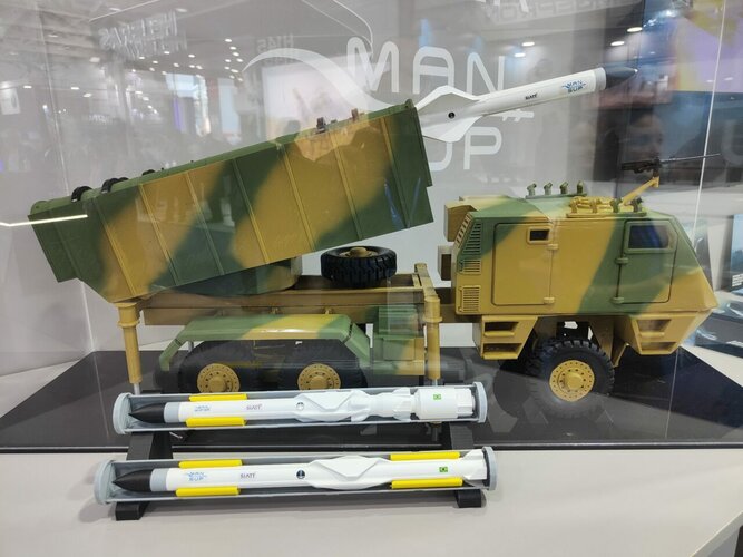

At the Sept. 24 public hearing by the Committee on Foreign Relations and National Defense on “Assumptions of National Sovereignty,” it was revealed that, among other projects, the Brazilian Air Force (FAB) is developing the MICLA-BR Brazilian Long-Range Cruise Missile.

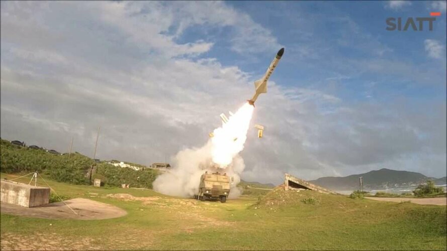

According to the presentation, the MICLA-BR is an air- launched development of the MTC-300 (or AV-TM 300) surface-to-surface missile launched by Astros 2020 vehicles.
