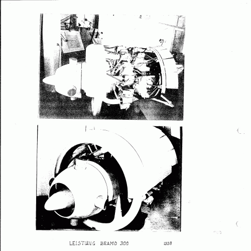

Courtesy of Herrn Richard Faltermair, here is the almost unknown Bramo 300 . It was a contemporary of the P&W R-2800 and the GR-18L, being the first german aircraft engine to attain such power and beating the BMW 140. Reaching (and exceeding in tests) 2000hP, it didn`t make it past the test benches since Ernst Udet forced the merger of Bramo into BMW. Although uniformity in aircraft engine production is a clever move, it (almost) killed the ingenuity of Bramo`s Spandau development office in piston technology. The exception was the amazing Bramo P.3031, later to become the 28 cylinder liquid-cooled radial BMW 803.

It looks very much as if the supercharger is between the propellor and the cylinders like the BMW 802. Could the two designs be related?
Cross polinization between these two firms began in 1938. It could be possible.
