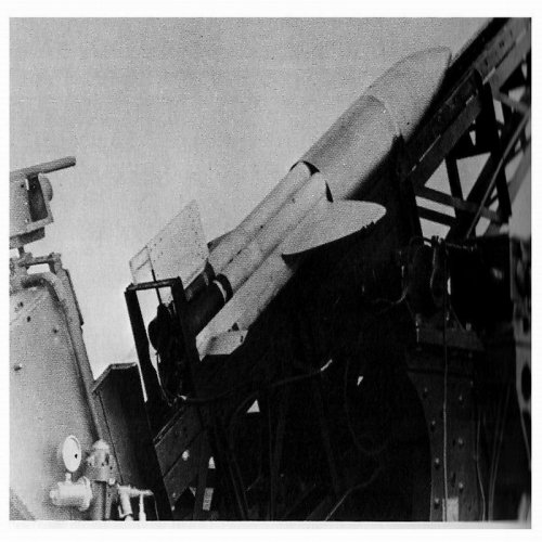

According to Bill Gunstons "Enzyklopädie der Raketen & Lenkwaffen" the trials actually
were relatively succesful (after some failures at the start), the reason for cancelling the
program were just the economical difficulties at the end of the war and the disbandment
of the design team. Brakemine started with four 3'' motors and moved on to six. Such
changes may have been more difficult, if producing a completely new motor would have
necessary, I think, the "modular" propulsion may have been more flexible.
(photo from the mentioned book)
