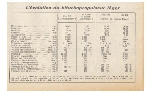

This is part of a larger article about the contenders for a 1960 Armée de l'Air competition for an army co-operation light transport and the other contenders were:-
Avions Marcel Dassault MD-415 Communauté (prototype).
Max Holste MH-260 Super Broussard (prototype).
Max Holste MH-261 Super Broussard (project).
The article comes from the 6th January 1961 issue of Les Ailes......

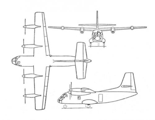

  • Bréguet Br.945 project 3-view drawing - Les Ailes - No. 1,807 - 6 Janvier 1961 1.......jpg
