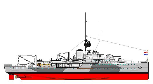

This is a top-view photo of the Flores in it's 1944 confiquration. Now I want to figure out where the Boulton Paul Type A turrets would be located.

According to this source (page 39), the BP turrets were placed where the motor launches used to be.
Shipbucket drawing via TracesofWar
So either they're both sides of the funnel, or just aft of the funnel where the crane is drawn in this image.
Oh thanks! That does clear things up. So if I put it all together I came to this conclusion:
The photo of the turret I showed above did state that it was of the Flores. So going on from there the turret was on the side of the ship, because you only see the water behind it.
That ruled out the position of the crane considering that is in the centre of the ship.
So what I thought I do is put them on their own little platform like shown in the image above. And I placed them in the spot where the motorboats would normaly be.
