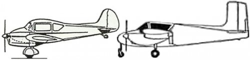

Links added for Terry (Caravellarella)'s post in Aerospace on the SIPA Sipavia-261 Anjou (1959 Les Ailes article) and Toura's images of the original Boisavia 260 Anjou.
