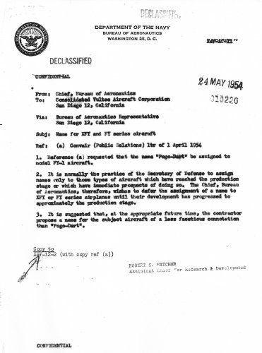

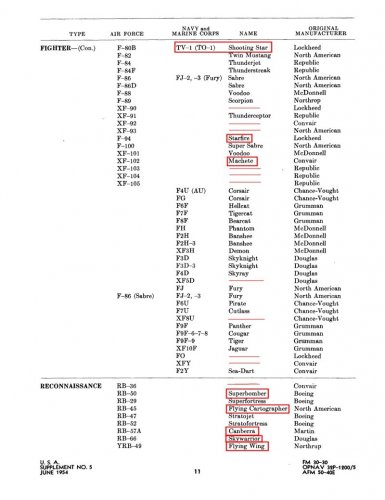

Skyflash and Navy Vertical Risers
Both Skyflash and D-558-3 are bogus. Douglas did not use either of these terms in its proposal in the competition for the X-15 program. In any event, "Skyflash" could only have become official if Douglas had won the competition and X-15 was predetermined.
As for the Navy vertical risers, you can see for yourself:
So Rising Star WAS Lockheed's chosen name, and Pogo-Dart was Convair's? (the latter comes as a real surprise to me, I'd never ever seen it)Brilliant! Thanks a lot for these precious documents, TT!
"Angel" and "Cygnus" were inhouse names for the programs, but as to whether they actually designated the aircraft themselves remains to be seen...
Moonbat and "The Bat" were unofficial McDonnell names to be sure. The FY-1 was named "Pogo" by Convair, but seems to have stuck and "Salmon" was used after the testing of the FV-1 was finished, to honour the pilot, Herman "Fish" Salmon.

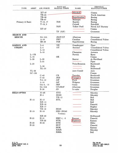

Actually I think THUNDERWARRIOR is one of the true company-given names, but we'd need documents to back it up.

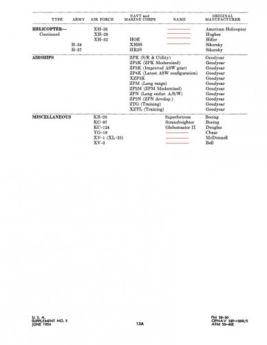

Still don't know if the XB-15 was the SUPERBOMBER for Boeing or the Army at some point, but here is something interesting I came across in the March 1938 issue of Mechanix Illustrated. Seems like the pilots didn't wait for official names to invent their own... and also that some of them stuck for good...

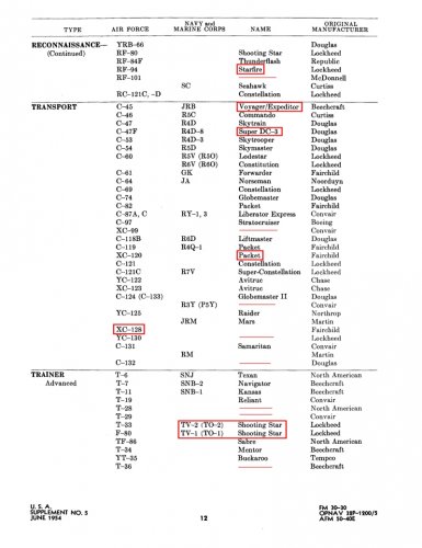

The validity of the F2L "Airacomet" is dubious to me. This suggests that the Navy designated its P-59s as F2Ls. I haven't seen any documentation for that although it is a possibility. However, everything Navy (e.g., list of first jet pilots) concerning the Airacomet that I've seen uses P-59. When BuNo 63960 was repainted by the Navy (see picture), the designation painted on it was YP59-A. (Yes, the dash is in the wrong place.)
The Navy History Center is not without fault. Its list of Bureau Numbers has those for the L-39s listed as canceled P-63s and identifies them as XF2Ls.
F2L does seem to have been used by the Navy for a couple of remote control P-39s, as in F2L-1K.
There was reportedly a crash of an F2L in 1946. I have asked the Navy History Center for a copy of the crash report.

The following five pages are taken from:
Aircraft Recognition Manual
SUPPLEMENT NO. 5
JUNE 1954
DEPARTMENT OF THE ARMY FM 30-30
DEPARTMENT OF THE NAVY OPNAV 32P-1200/5
DEPARTMENT OF THE AIR FORCE AFM 50-40E
I have indicated in red those designations and/or names which deserve some attention.
I will comment briefly below as to why:

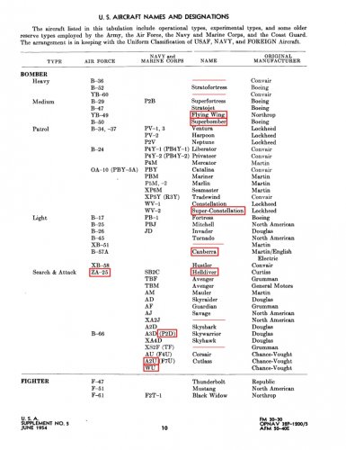

BOMBER
  • B-36/RB-36. Interestingly the name "PEACEMAKER" is NOT associated to it.
  • YB-60. No name associated to this version ("JET PEACEMAKER" was never official).
  • RB-45. Interestingly, the name TORNADO was replaced here by the unusual FLYING CARTOGRAPHER.
  • YB-49/YRB-49. The name FLYING WING was officially allocated.
  • B-50/RB-50/TB-50. Clearly this has a distinct name from the B-29, it is called SUPERBOMBER.
  • WV-2. The name SUPER-CONSTELLATION was also allocated here, NOT "WARNING STAR".
  • B-57/RB-57A. The original British name CANBERRA was officially allocated by USA.
  • RB-66. Surprisingly this appears as the SKYWARRIOR and NOT as the "DESTROYER".
  • ZA-25. The type was still in the roster in 1954, but as the HELLDIVER, and NOT the "SHRIKE".
  • A3D. Probably the most uncanny discovery in this document, a version was to be designated P2D!
  • A2U. The designation for the attack variant of the CUTLASS was quite official.
  • WU. The designation was officially allocated before the type was cancelled.
FIGHTER
  • F-94/RF-94. The name STARFIRE was applied to EVERY variant, not just the F-94C.
  • XF-90. No official name allocated.
  • XF-92. No official name allocated.
  • XF-93. No official name allocated, not even "SABRE." Interestingly, the type was actually designated YF-93.
  • F-102. The initial name officially assigned to the type was MACHETE, and NOT "DELTA DAGGER"!
  • XF-103. No official name allocated (the name "THUNDERWARRIOR" is sometimes quoted as a company monicker).
  • XF-104. No official name allocated at that stage (it became the STARFIGHTER).
  • XF-105. No official name allocated at that stage (it became the THUNDERCHIEF).
  • XF5D. No official name allocated at that stage (it became the SKYLANCER).
  • XF8U. No official name allocated at that stage (it became the CRUSADER).
  • FO. No official name allocated ("SALMON" was only a nickname). Redesignation as FV overlooked. Interestingly, no "X" added.
  • XFY. No official name allocated (the company name POGO-DART was rejected, POGO or POGO-STICK were just nicknames).
TRANSPORT
  • C-45. The name VOYAGER continued to be given to certain variants, not just EXPEDITOR.
  • C-47F/R4D-8. Surprisingly the company designation SUPER DC-3 was adopted as an official name here!
  • XC-120. The USAF apparently prefered the usual PACKET instead of the company name "PACK PLANE."
  • XC-128. Oddly this cancelled variant of the C-119 did not receive the name "PACKET."
  • YC-130. No official name allocated at that stage (it soon became the HERCULES).
  • C-132. No official name allocated.
TRAINER
  • T-28. No official name allocated at that stage (it soon became the TROJAN).
  • T-29. No official name allocated at that stage (it soon became the FLYING CLASSROOM).
  • T-33/TV-2. The name SHOOTING STAR was also officially associated to the trainer variant.
  • T-36. No official name allocated.
  • XT-37. No official name allocated at that stage. Amusingly, this is repeated twice, with the MITCHELL name on the wrong line!
  • N3N. The name YELLOW PERIL was official and not just a nickname (the quoted "CANARY" is wrong).
  • TF (S2F). No official name allocated at that stage (it later became the TRACKER).
LIAISON AND UTILITY
  • L-13. No official name allocated.
  • L-21. No official name allocated (the name "SUPER CUB" was only a company name).
  • L-24. No official name allocated (the name "COURIER" was a company name).
  • XL-25 (XV-1). No official name allocated (the name "CONVERTIPLANE" was not official).
HELICOPTER
  • H-4B/HNS. No official name allocated (the name "HOVERFLY" was only given by the British).
  • H-5/HO3S. No official name allocated (the name "DRAGONFLY" was only given by the British).
  • H-13/HTL. No official name allocated at that stage (it later became the RANGER and SIOUX).
  • XH-16. No official name allocated at that stage (it became the TRANSPORTER).
  • XH-17. No official name allocated (despite its sometimes being called the "FLYING CRANE").
  • H-19/HRS/HO4S. No official name allocated at that stage (it became the CHICKASAW in Army guise).
  • XH-20. No official name allocated (the company name "LITTLE HENRY" was never official).
  • YH-22/HTK. The little-known name EXPLORER was officially allocated.
  • H-23/HTE. No official name allocated at that stage (it became the RAVEN).
  • H-25/HUP. No official name allocated at that stage (it became the ARMY MULE in Army guise).
  • XH-26. No official name allocated (the names "JET JEEP" and "WHIRLY BIRD" were not official).
  • XH-28. No official name allocated (despite its sometimes being called the "FLYING CRANE").
  • XH-32. No official name allocated (the company name "HORNET" was not official).
  • H-34/XHSS. No official name allocated at that stage (it became the CHOCTAW, SEA BAT and SEAHORSE).
MISCELLANEOUS
  • YG-18. No official name allocated (only when given engines it became the AVITRUC or XC-122).
  • XV-3. No official name allocated (the name "CONVERTIPLANE" was not official).

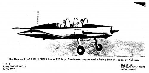

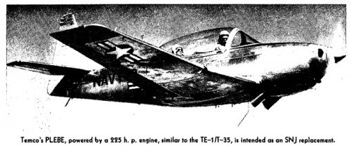

The U.S. AIRCRAFT ADDENDA published in SUPPLEMENT N°5 (June 1954) already contained some changes:
  • The Lockheed FO was now officially the XFV-1.
  • The Piasecki YH-16 was now refered to as the TRANSPORTER.
  • The XC-120 was now called the PACKPLANE.
  • The Lockheed PO-1W (an AEW CONSTELLATION) was described as "sometimes called the FLYING LABORATORY."
  • The De Havilland L-20 BEAVER was added.
  • The Hughes XH-17 was called the FLYING CRANE.
  • The Temco BUCKAROO was added and wrongly designated the "YT-33"...
  • The Temco PLEBE is presented as an intended SNJ replacement for the Navy.
  • The Lockheed SEASTAR (not yet called thusly) is designated as the "latest model T-33/TV-3" (NOT T2V-1!)
  • The Fletcher FD-25 DEFENDER appears (photo of a civil example), but nothing is said of a possible U.S. military use.

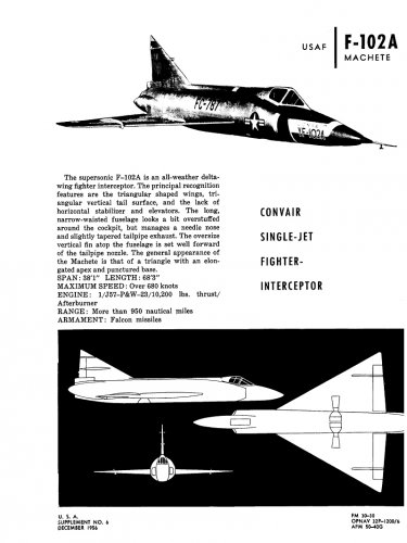

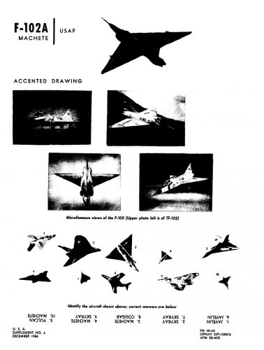

It seems surprising nowadays, but the name MACHETE for the YF-102 stuck quite officially with the YF-102A as late as 1956!
