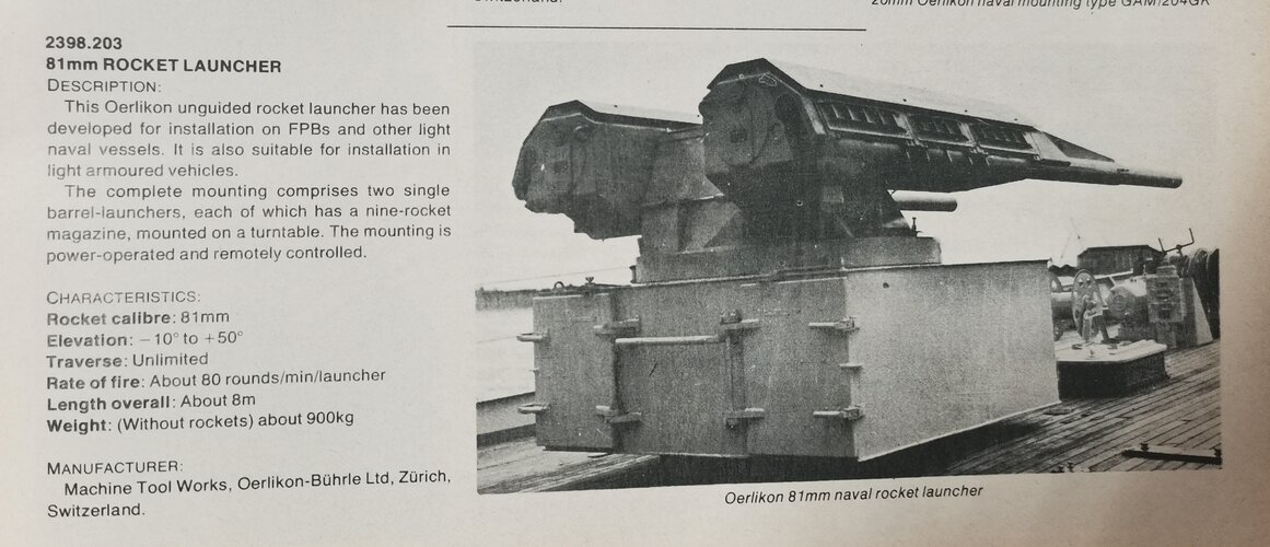

Then I have to say I do not know of any such system. If you have a picture or reference, that would help.
I definitely cannot think of any sort of automatic rocket launcher attached to the side of a gun turret. Definitely nothing from Bofors that fits that description.
My mistake.
It is not bofors.
To TomSerfect!and thanks!My mistake.
It is not bofors.
Ah, that's an obscure one.
Turns out it was tested on PTF-13, one of the Nasty class fast patrol boats. I don't think it was ever adopted by the USN though, just tested.
Post in thread 'Semi-automatic or fully-automatic recoiless guns' https://www.secretprojects.co.uk/th...ly-automatic-recoiless-guns.18338/post-177140
Also, a passing reference here. Seems that PTF-13 was a training and test& evaluation boat and saw a lot of experimental weapon fits, including the Oerlikon launcher.
