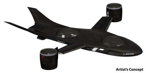

Artist's impression of Boeing Phantom Swift.
http://www.air-cosmos.com/upload/18/pics/2014/06/tablet/53aa8490e9e6c.jpg

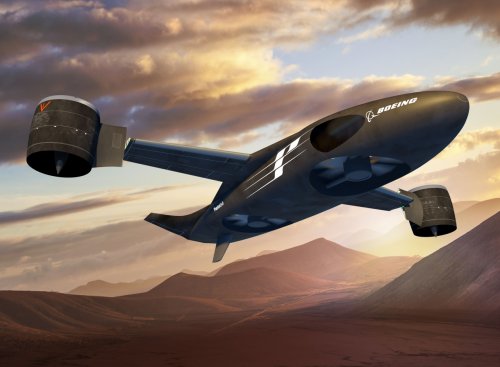

Higher Res Boeing Phantom Swift 3D concept
A.
