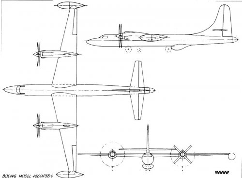

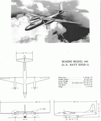

has anyone a drawing to this Model ? please.
if you have not a drawing,can you tell it was a flying boat
or normal aircraft ?.
The Boeing Model 466 was a land-based long range patrol aircraft
powered by two 5.200hp Allison XT-40 engines driven contraprops.
Span: 110ft. Lenght 90ft6in.Gross weght :92.000lb.
Tanden type undercarriage with outrigger wheels in engine gondola's.
service designation : XP3B-1 - type not built.
Boeing Aircraft since 1916 - Peter M.Bowers. Putnam .London1989.

The overall description sounds roughly like a XB-55 derivative with only one engine pod on each side.
Very close Evan but the wings and tailplane were not swept..
From Boeing Aircraft Since 1916 by Peter M. Bowers:
