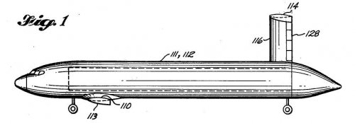

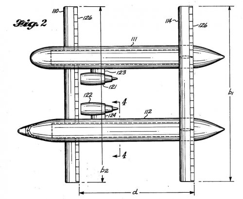

Boeing twin boom spotted in Aviation Week's Leading Edge blog.
Boeing's design is described as having "two independent spaced apart fuselages and two wings of similar area", the lower forward wing attached to the forward fuselages and the upper aft wing mounted on struts so the tips of the wings are separated vertically by at least 25% of the span.The wings have to be spaced apart to avoid the wake from the forward wing having an adverse aerodynamic effect on the aft wing. The Airbus configuration mitigates this by carrying less lift on the forward wing than the aft wing, and using forward sweep to minimize the vortices shed by the forward wing. Together, these allow the aft wing to be attached directly to the rear fuselages, saving weight. The engines can then be mounted on the aft wing, on the centerline, with adequate ground clearance.
