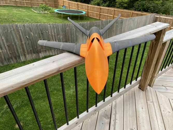

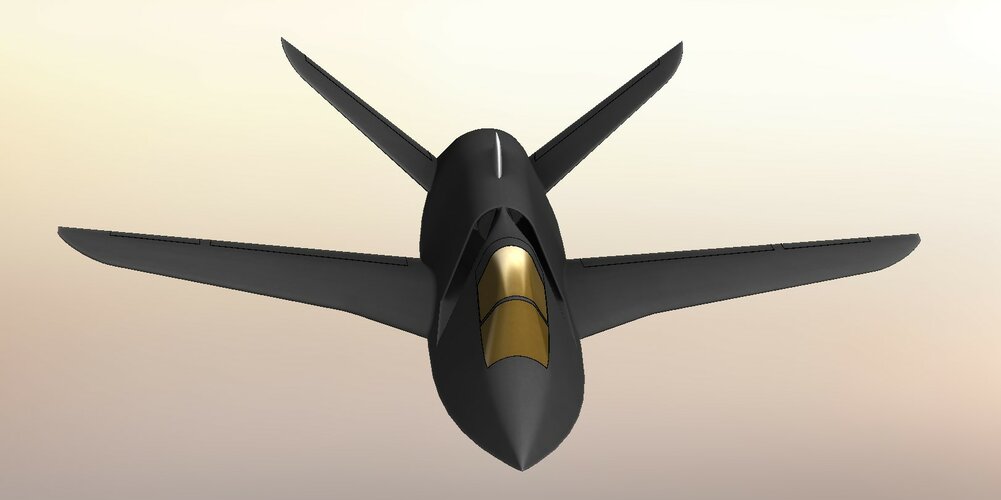

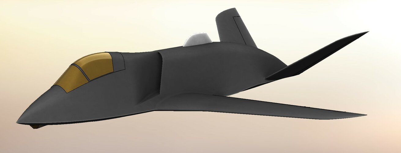

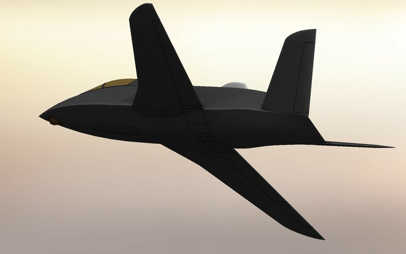

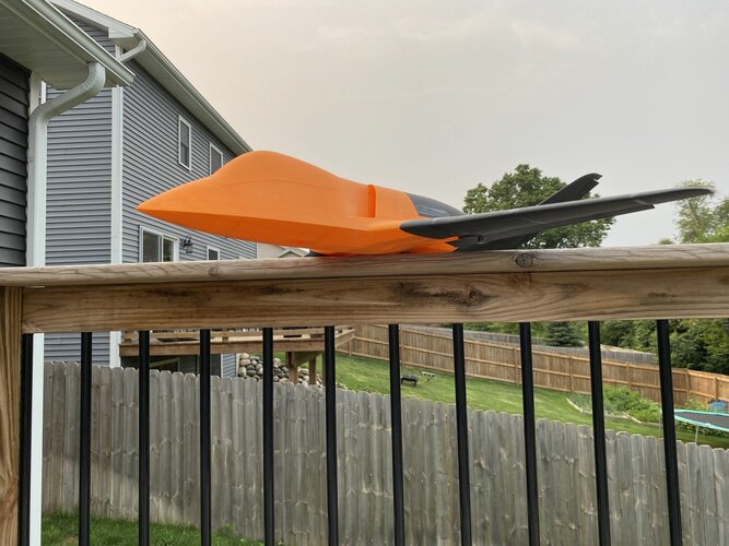

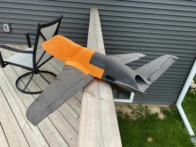

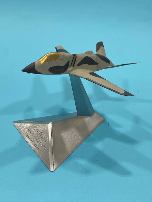

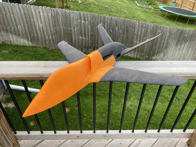

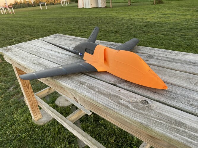

I have been smitten with this little guy for a lllooonggg time. Cooked up a CAD model and 3D printed out a 1/72 scale model and a RC model...the RC model did not work well. Intake sucked and not in a good way! Wing planform contributed to some significant tip stall tendencies that led to the 4 takeoffs quickly leading to 4 landings on its back.

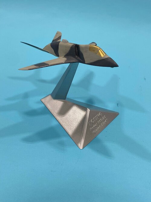

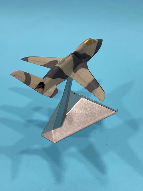

For the 1/72 I added a semi-fictional glass housing under the nose for a camera and painted it sort of like a US Army YO-3A in Vietnam.

For RC did you try cheater holes on the underside? Or even just a full intake.
Yep this one had 2 cheater intakes on the bottom that would also provide cooling air to the ESC. They vented into the intake via over-sized slots inside the inlet. Roughly emulating a boundary layer system.
I have a significant re-worked design under way which completely opens the inlet up. If you are wondering what a Quiet Bird would look that functions better, I refer you to a couple Scaled Composites airplanes! (401 and 437)
