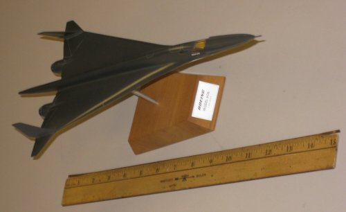

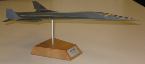

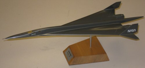

Is the Model 733-606-12 the same as the so-called "Model 606" shown here? Certainly looks it.

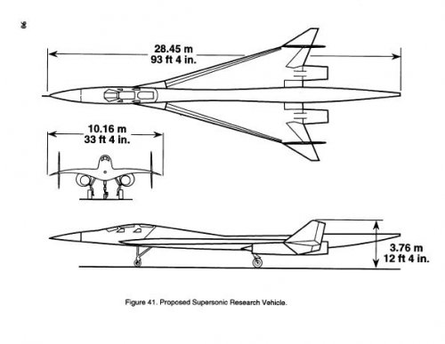

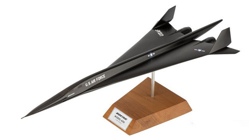

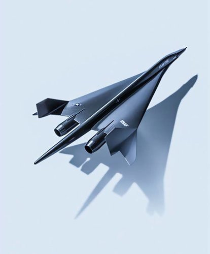

Probable Boeing 733-606 image from "Aeronautical Technology 2000: A Projection of Advanced Vehicle Concepts" (http://hdl.handle.net/2060/19860003767), titled Advanced Fighter Aircraft.
