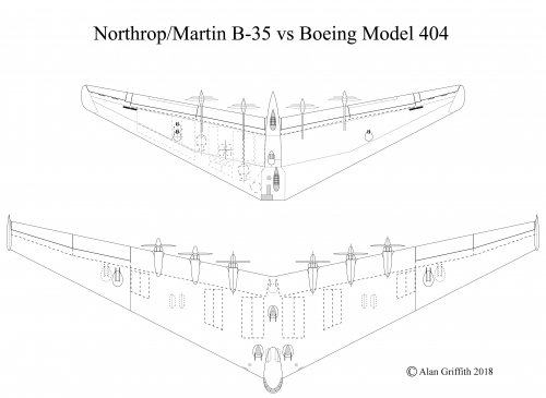

Does anyone have drawings or specs of the Boeing Model 404 flying wing bomber? I just wanted to ask because I saw the designation in the Boeing model numbers list and the Model 404 had the same number of engines as the XB-35 and Consolidated Flying wing design.
I am very hesitant to share these drawings of the Boeing 404 as I am sure some "researcher" will steal them. However, in the interests of furthering aviation history and research I present to you a 3-view drawing of the Boeing Model 404 done from original USAAF drawings in my files. I am in the process of long-term research on a future book title for which these were done. I have a large amount of data on the 404.
The other drawing is a comparison of the what would have been the Martin-produced version of the B-35 (Northrop had nowhere NEAR the production capacity to mass-produce an aircraft of this size) and the Boeing 404. As you can see, the 404 was a much larger aircraft.
Presented for you consideration,
AlanGView attachment 615660View attachment 615661

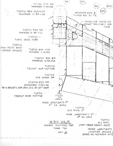

I have the interior arrangement drawings and drawings of the engine installation. I've been working on a drawing of this airplane. Here's a sample scan. Too many drawings to scan and upload. I can make you a copy of the drawings if you send me an email. Rich
  • boeing 404 scan.pdf
