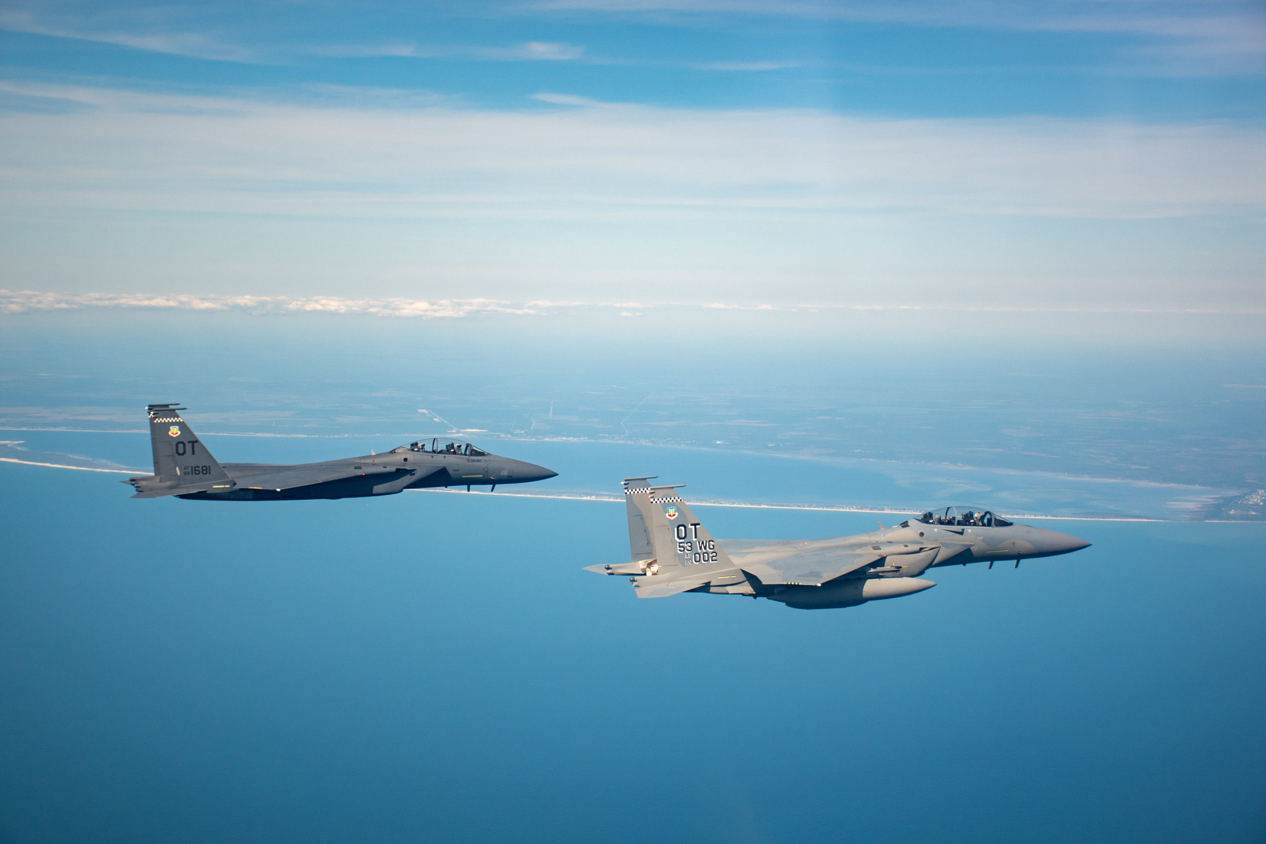

What's that thing attached to the eagle under the canopy?
If you mean that thing next to the canopy, it's the mounting for the MAWS (AN/AAR-57A(V) CMWS). SA Ealges have an actual AAR-57 mounted on that spot, as well as for QA iirc. Since the UV wavelength is very short, its primary purpose is to detect possible MANPADS launch near the airstrip. That obviously doesn't mean it wouldn't be used in ACM or BVR engagement tho.

Part of EPAWSS apparently

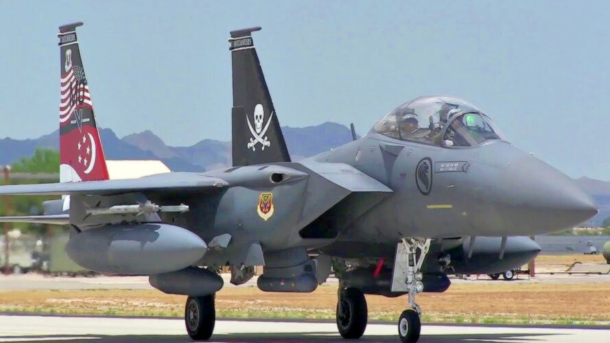

Sevreral other countries have them as well. Singapore for example:
The SG aircraft as well as the ANG F-15EX doesn't have the MAWS, so its a dummy mounting. I wouldn't be surprised tho, if that compartment later could be used for an actual equipment mounting point.
Why go through the expense of mounting a dummy?
I'm not exactly sure and can't think much valid reason, if any, to why they've placed a dummy mount tbh.

Just a WAG, but maybe it's presence has some deleterious aerodynamic effect, which the FCAS compensates for, and it's quicker/cheaper/easier to fit a dummy fairing, rather than reprogram the FCAS to handle it's absence . . .

That is most likely the case for the Advanced Eagle family with FBW controls, that is F-15SA, F-15QA and F-15EX. It has only been certified with the blisters so the blisters stay on regardless if you install a MAWS sensor or not.
This is not the case for the F-15SG, which is why I think the RSAF Eagles fly whithout MAWS for regular ops but have them in storage, or they are fitted for but not with.
I think it is for upgradability. On the F-15EX, I believe the MAWS and a towed decoy are a future enhancement not currently part of the program of record.
