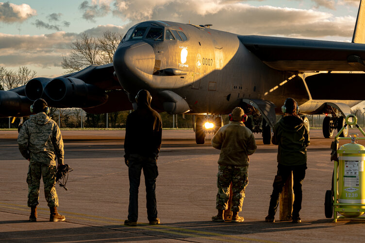

Just wanted to share this great shot (B-52H Stratofortress taxis at RAF Fairford Feb. 27, 2025)
Making its rounds in Europe
