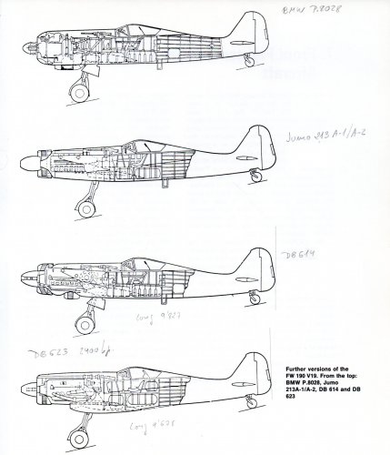

What configuration, R14 or R18 was this engine? Anyone know the capacity? Supposedly 1550hp at altitude(?).

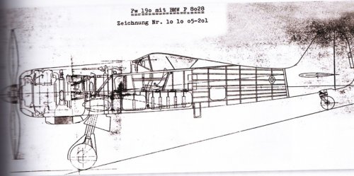

FWIW, the Focke Wulf Projektnummer for fitting the Fw 190 V19 with a BMW P.8028 is listed as: 10 10 05-201. 10 10 05-202 was for the BMW 801J and 10 10 05-203 for the DB 609.
http://www.flying-things.ch/fockewulf.htm
(Drawing numbers ... thanks for the correction newsdeskdan)
