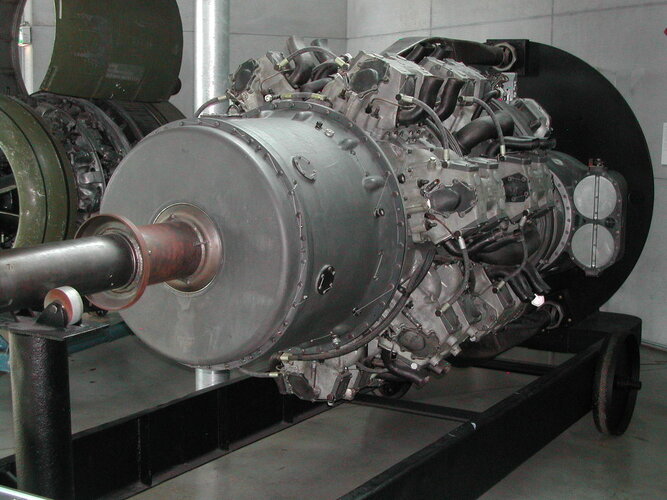

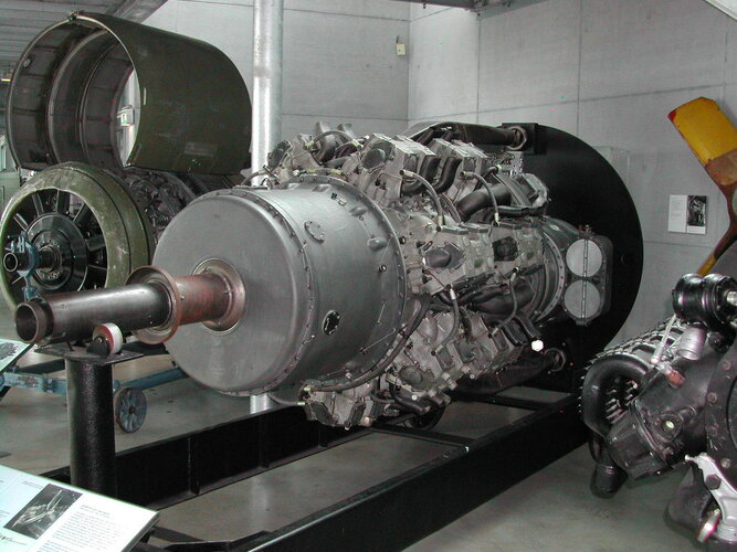

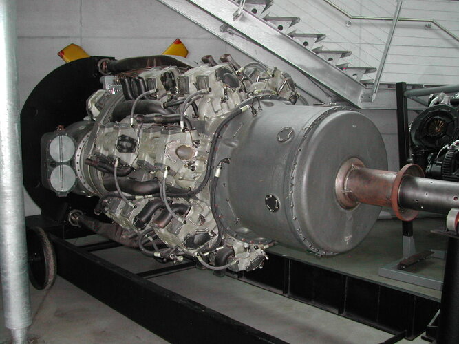

Here are a view pictures from my visit to the "Deutsches Museum, Flugwerft Oberschleißheim" on
28th of June, 2008. There is also a BMW 803 there.
regards
Oliver
