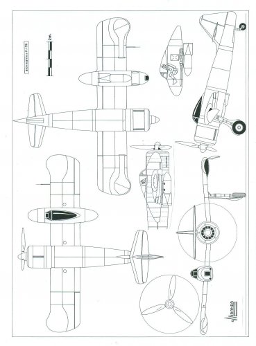

Fighter bomber project with rotating wing
Anyone have any more info or drawings?

All I know,
it was powered by one 1700 hp BMW 801D engine.
Excellent contribution, Gary. More like a variable incidence wing than a rotating one. I would dare to ask Peter to produce an attempt to ressurrect this "paper-plane".

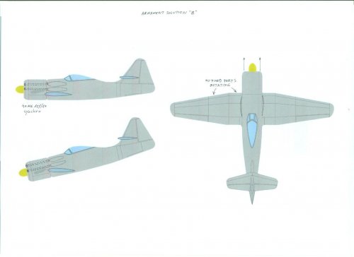

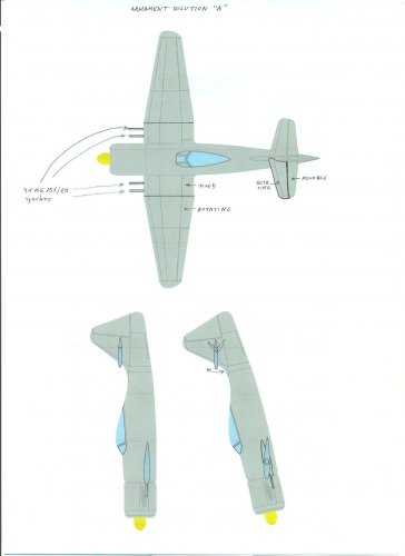

Hi Peter

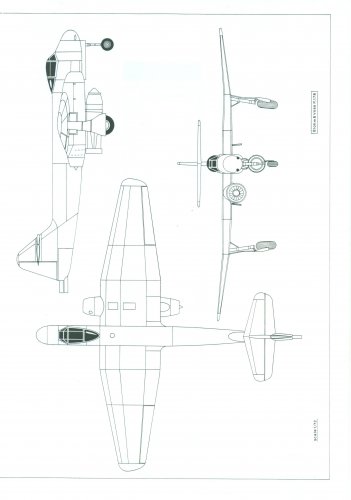

Wingspan 10,5 m.
Length 8,9 m.
Engine and propeller from an Fw 190.
Tailplane from B&V P.179

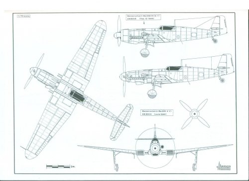

Wing from B&V P.178 (corrected to symmetric plan)

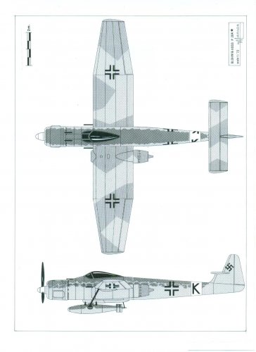

Canopy from B&V P.204
Camo from Fw 190 F
Role ground straffing

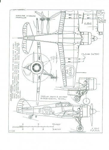

An interesting point will be the landing gear, I think. Either the wing has to be brought into a pre-defined postion, probably
negating some of it's positive effects, or the gear would have to be completely fuselage mounted, not that easy, although
the Swedish FFSV J-22 comes to my mind. But then, obstruction by the rotated wing would have to be ruled out.

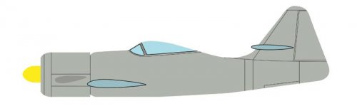

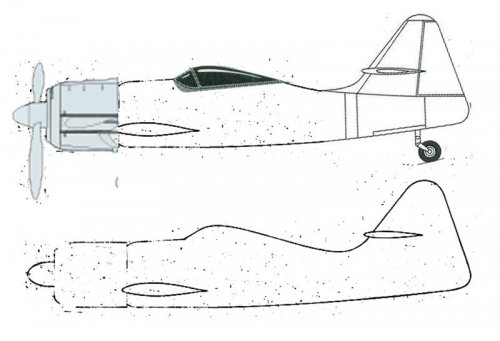

Made a little start. Cobbled together a patch-work side view, using bits from Justo's diagrams.
It's rough but it's started to show.
I realise there's a bit more smoothing out the joins but comments, suggestions and corrections are very welcome.
More soon
Peter :D

A little more.
General basics side profile.
Peter :D

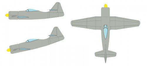

A bit more progress.
Now done basic plan view. The fuselage seems a little fat.
Any suggestions, errors or modifications please?
On the original drawings I noticed in the dive position the tailplane looks like it should also rotate (?)
More soon...
Peter

Hi Peter,
the fuselage is just what it is according the original drawing, fat! Please stick to it to remain true to the original. The tailplane rotated, I guess sincronyzed with the wing.
Seems logical to me, that the tailplane rotates, too.

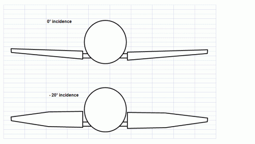

A question still unanswered, I think, is the wing fuselage junction. There must a
gap between fuselage and wing to allow the rotating wing to clear the fuselage sides,
but I cannot imagine a suitable cover, as here it would have to cover quite an area
with quite a high elasticity.

I would suggest a straight, chordwise break at the wingroot fairings which would remain fixed relative to the fuselage and only be aligned with the main wing in conventional, high speed mode but not during the attack run. And yes, the tailplane could be variable incidence as well, with or without a separate elevator, though I would tend to go with the separate elevator unless there are other B&V designs of the period with all-moving tailplanes.
Ah, yes, a good idea, although I somewhat would have expected such a layout to be recognisable even
in the very basic sketch, we've still yet seen.
About the tailplane, I think, it would rather be an increased range for trimming, than a completely new
construction. AFAIK, trimming was done this way for a several aircraft.

I've been pondering...not always advisable I know...but if the wing rotates directly against the wing roots/fuselage side would there not be a need of some kind of rubbing area? Otherwise if the wing roots extended a little away from the fuselage sides, the wing could rotate without any problem, mechanism not-withstanding. See where pondering gets you....

Fancy wing root fairings (e.g. Spitfire) can be eliminated if you simply make the fuselage sides flat (e.g. Sky raider) where the wings rotate (change incidence). As long as the intersection angle approaches 90 degrees, drag is negligible.
Also consider that wing-mounted under-carriage is still viable if you always land at the same wing setting. Same wing setting means consistent touch-down angle and simple under-carriage.

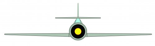

Merely to get proportions. Details of revolving wing to be added as it progresses.
Jemiba did a little plan earlier.

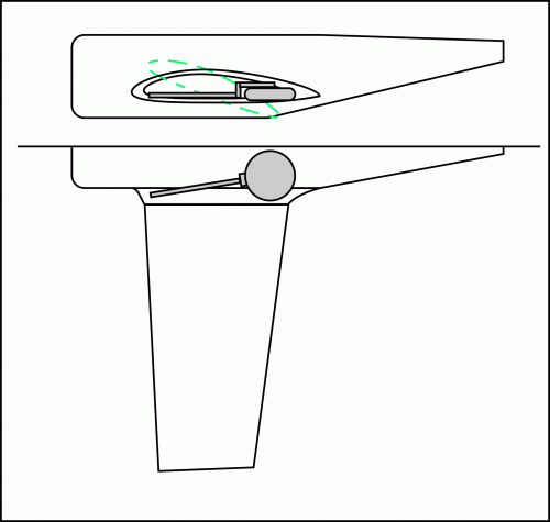

Indeed !
A fixed wingroot fairing, as proposed by cluttonfred (#20) maybe could
alleviate problems with the landing gear. Would result in a quite narrow
track width, but that was a problem of many aircraft then.
Indeed !
Bearing in mind the P.180 looks to be a lash of a set of P.178 wings, likely retaining the main gears, married to a modified P.179 fuselage, why would any sensible engineer move the u/c from the wing to the fuselage, especially an area already full of actuator equipment to move the wing?
Other than some of the jet proposals, B&V always went for wide track so why make something more complex than it need be?
