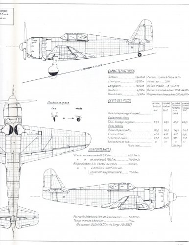

From
-"Le Bloch MB.152" by Serge Joanne
Lela press 2003

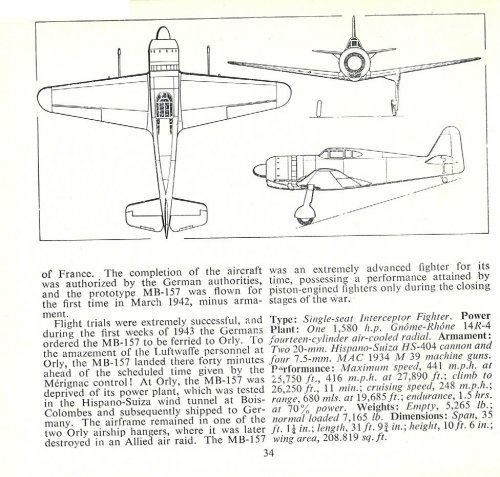

From
War Planes of the Second W.W. Vol. one
by William Green
Macdonald 1963

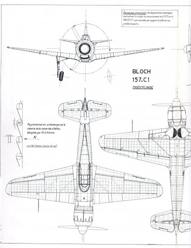

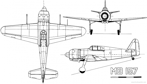

Hi! Another MB.157 three side view drawing.
Indeed, the propeller's thrust line is tilted against the longitudinal axis of the aircraft.
https://arnor022.deviantart.com/art/Detail-Bloch-MB-157-570190059
https://www.the-blueprints.com/blueprints/ww2planes/various/82253/view/bloch_mb-157/

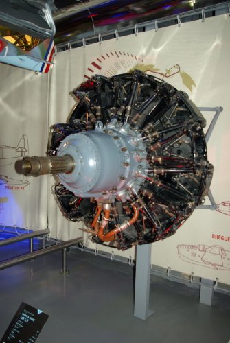

Gnome-Rhône 14R engine.
https://en.wikipedia.org/wiki/SNECMA_14R

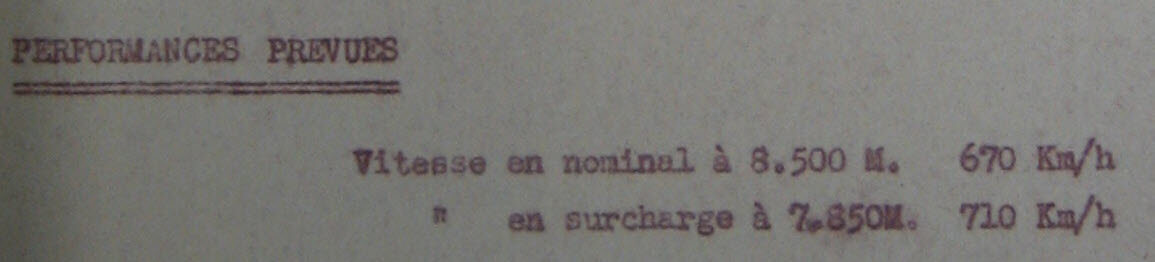

According to http://sam40.fr/les-derniers-chasseurs-bloch-157-100-1011-1040-entre-mythe-et-realite/, that speed seemingly made its appearance no later than 1943, in a company brochure, as a predicted or expected speed (441 mph at 25,750 ft), under some sort of wartime emergency power condition - and not as an actual speed achieved during testing.
It is worth noting that the aircraft was then referred to as the SO 157. Marcel Bloch, who was Jewish, was no longer an acceptable chief designer. Indeed, he had been interned / arrested by the Vichy government in October 1940.
I agree. I have got an original copy of this SO 157 notice. I can confirm that these performances are calculated.
Unfortunately, I never found flight reports about this plane.
