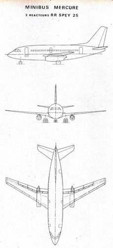

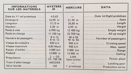

hesham said:
From Jane's All the World's Aircraft 1965-1966,
here is early drawing to Dassault-Breguet Mercure,completely different,it had a
rear mounted engines.
I think I can solve this problem,maybe this aircraft was the Dassault Mystere 100.
Flying Review 8/1963

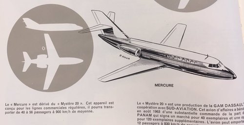

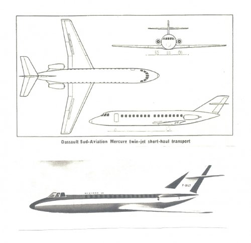

Hi all
see the"mystere 20" which became"mystere 30"
after change of engines
and the project" mystere 30" which became project mercure
and was change for the Mercure we know

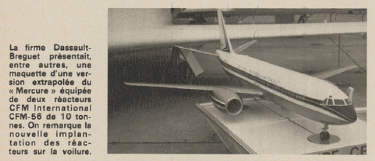

From Aviation magazine 1975.
