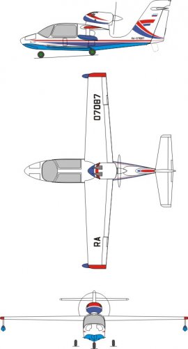

from Beriev site,here is the Be.101 light amphibian,it is intended
for commercial and non-commercial operations.
http://www.beriev.com/eng/Be-101_e/be-101_e.html

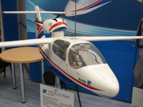

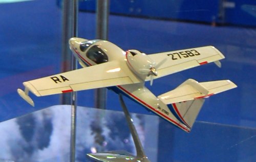

A model of the Be-101:

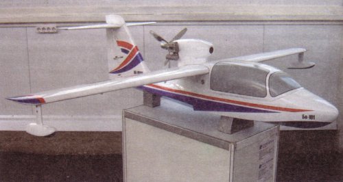

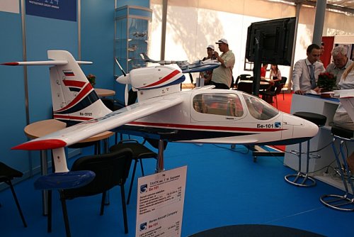

Trade show display model and radio-controlled model of Beriev Be-101.
Per Unflown Wings by Yefim Gordon and Sergey Komissarov, "the shape of the engine cowling suggests a turboprop engine", page 419.
http://vpk.name/news/56978_tantk_im_berieva_pokazhet_na_gidroaviasalone2012_samolet_be101.html
http://aviadejavu.ru/Site/Crafts/Craft22422.htm
