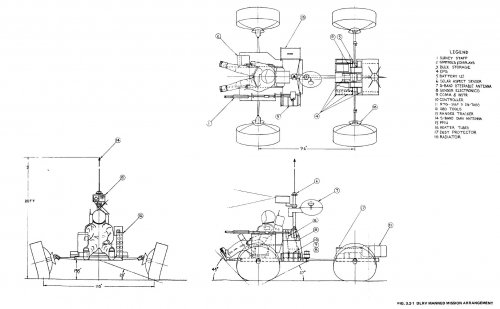

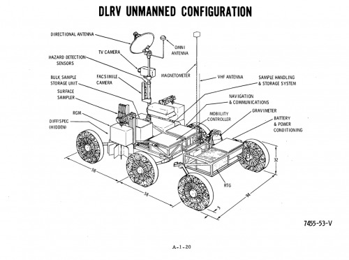

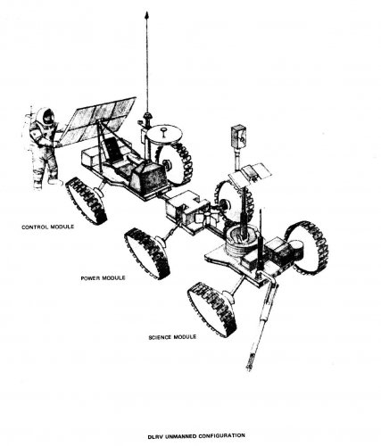

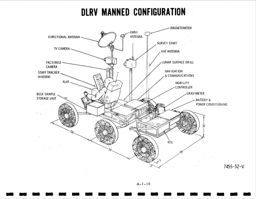

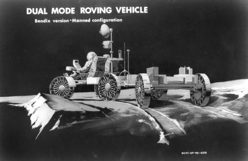

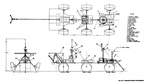

Triton said:
blackstar said:
Powered by an RTG.
Radioisotope Thermoelectric Generator?
Yes, because Dual Mode LRV needed allot power like for tools like Lunar surface drill
and after the Manned mission for the remote control exploration.
Wat take several months (or several Lunar day and Nights)
so battery or Solarcell were out of question
There's also the two-week lunar night. That wrecks havoc on batteries. Even if you went with batteries and solar power, you'd need a radioisotope heating unit.

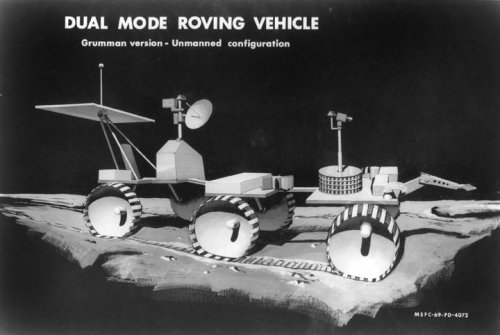

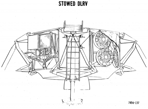

Anothe concept of dual mode rover from GRUMMAN is that:
...One other thing to consider is that there would need to be some sort of automation and/or robotics to open/close the shutters on the wax packs, which were used on the Rovers as a form of heat sinks. IIRC - and I may have this backwards - the shutters were closed to allow the wax to melt and collect heat from the Rover's instruments, and opened to allow the extreme sub-zero Lunar surface temps in shadow to syphon away the heat and cooled the wax back to a solid, ready to recycle the process when it was time to saddle up and ride. Again, IIRC, this required that the Rover be parked so that the bulk of it was between the wax packs and the Sun, in order to provide as much shadow as possible. I'd have to review the footage from the Spacecraft Films remasterings, but until final ascent the Rovers may have been parked between EVAs in the shadow of the LM to assist in keeping the Rover electronics cooled.
