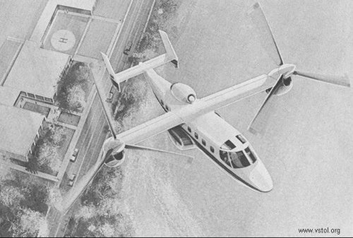

Artist's impression of Bell D-303 titlrotor.
Via Internet Archive:
Using the same amount of fuel as a helicopter, able to fly twice as fast and twice as far. Design is for ideal use on the North Sea. Projected to be operational by 1990.
  • Unloaded Weight: 5,460 kg.
  • Capacity: 16-20 passengers
  • Application Equipment (6,087 kg.): snow and ice removal, pressure ventilation, emergency equipment, additional avionics
  • Crew Weight: 154 kg.
  • 16 Passengers' Weight: 1452 kg.
  • Fuel and Oil Weight: 1,374 kg.
So what's that mounted on top of the fuselage, the single engine? It seems like you'd want the first civil tilt-rotor to have more than one engine and that placing it over the cabin would have a whole lot of disadvantages.
You'll find the answer in Stingray's Rotorcraft Forum (http://stingraysrotorforum.activeboard.com/t37000854/bell-aircraft/?page=3&r=406041)
"..For this project, Bell selected three General Electric T700 engines in order to comply with FAA and CAA one-engine
inoperative requirements. Two of these engines were used to drive the three-blade tilting rotors, the third one was on
the back of the fuselage in a horizontal position."

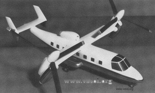

Another picture of this configuration via http://www2.ucatv.ne.jp/~kojik.sky/Dseries.htm from vstol.org :
Greetings All -
Here's a color version of the artist's rendition:
http://www.secretprojects.co.uk/forum/index.php/topic,1222.120.html
