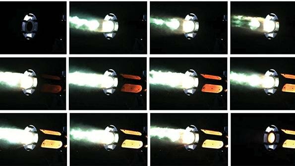

Two burn tests, each of 35 sec., resulted in no damage to ceramic-matrix-composite combustion. Credit: Bayern-Chemie

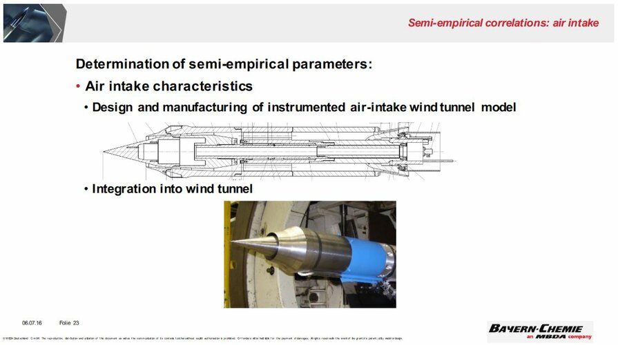

Under the funded feasibility study, Bayern-Chemie tested a model of the air intake in a tri-sonic wind tunnel in Cologne, Germany. The intake is opened by translating the compression cone backward, then an oblique shock system compresses and decelerates the air as it enters the annular duct.
Development resulted in an intake able to operate from Mach 3.5-5-plus, with an advanced boundary-layer bleed system to help start the inlet and a sensor system that enables the flight controller to adapt fuel mass flow into the combustion chamber to stability conditions at the intake.
The company also tested a carbon/silicon-carbide (C/SiC) combustion chamber for the ducted rocket. To withstand the temperatures inside and outside from both combustion and aerodynamic heating, a conventional metallic chamber would require internal and external thermal protection systems. This would increase the bore thickness and reduce the volume of propellant for the boost.
To maximize the integral booster’s size and push the Mach number at which the TDR takes over as high as possible, Bayern-Chemie developed a C/SiC combustion chamber without any thermal protection. Tests were conducted to see how the design withstands pressures, temperatures and erosion from the particle-laden combustion gas.
In two runs representing the climb (booster) and cruise (TDR) phases of an intercept, with an overall burn time of more than 60 sec., the simplified test chamber suffered no significant damage from erosion, a combustion temperature of 2,500K and static pressure of 6 bar, the company says. The tests suggest burn times of 120 sec. are achievable, which would widen the TDR’s operating regime, the company says.

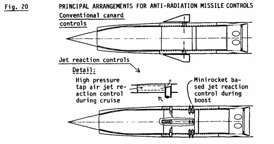

and a sketch of an alternative integrated configuration for ARMIGER using a chin intake:

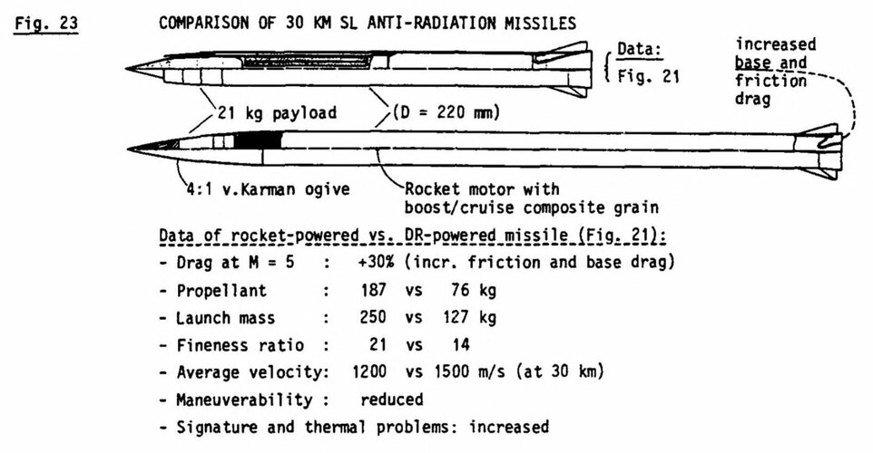

Fig. 10 gives a comparison of modular and non modular concepts from a German Anti-radiation missile study,
where the integrated concept provides superior kinematic performance on the expense of increased interface
complexity and potential component interaction.
In case of an infrared seeker, a non modular chin air intake missile configuration can provide a superior missile
performance, if the significantly inclined seeker window forms part of the air intake compression surface well within
the capture stream tube and thus without generation of missile external wave drag.

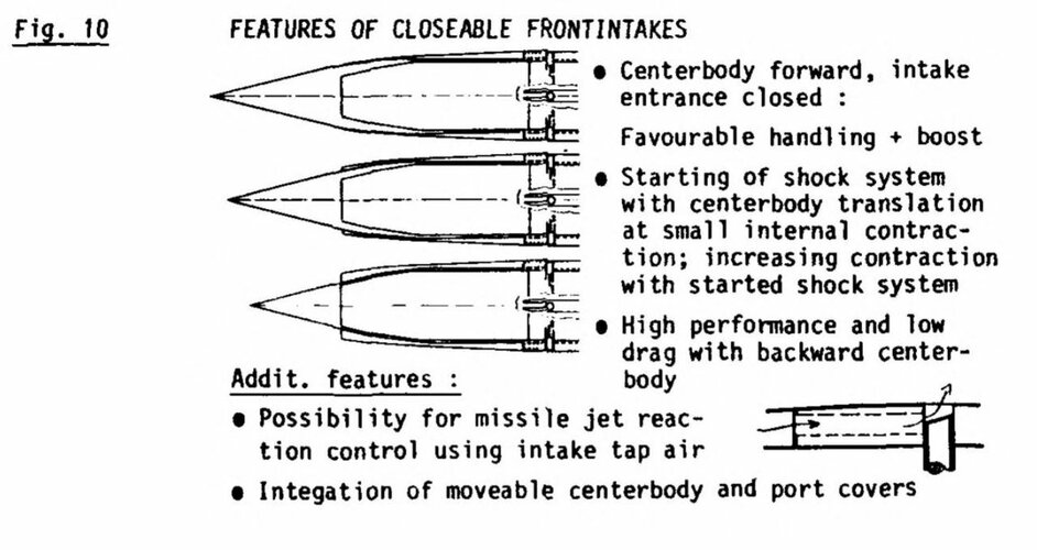

This paper by Bayern Chemie is behind a paywall, but it has some nice information on the design priciples behind the Throttleable Ducted Rocket used on the Meteor and some other applications for this engine. It also has a drawing of a Meteor-SAM using a booster similar to the ASTER:

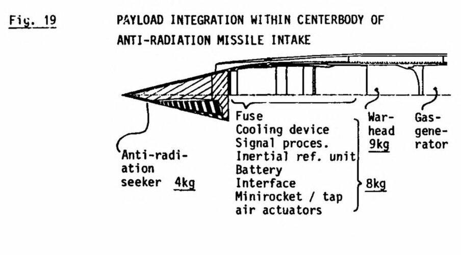

The paper also has a integrated more optimized configuration for a ramjet-SAM using a circular nose-intake. Confusingly the exact same configuration was discussed in an older AGARD conference paper by Bayern-Chemie for a anti-radar missile. Both papers even use some of the same diagrams.

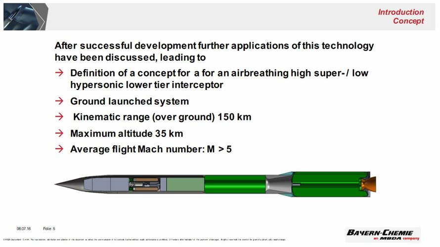

Bayern Chemie Powerpoint with a bunch of information on the Ducted-Rocket Interceptor

Both the Meteor SAM described and the Bayern Chemie Ducted-Rocket Interceptor design are depicted with boosters of similar size as the ASTER 15 and second-stages also of similar size to ASTER . On both missile designs the estimated range (150km) exceeds the range of the ASTER 30 an area air defence missile and matches the range of the SM-2 missile. All the missile fit only 1 per cell. the quad-packable ESSM and CAMM-ER have ranges around 50km. These are different missile categories.
Even if you removed the first stage and only used the integral booster these missiles wouldn't be quad-packable. And i have severe doubts that it would be possible to decrease their size substantially. Ducted-Rocket dimensions are constrained by the diameter of the gas-generator plus the air-intake. The control-valve in the generator necessary to make the missile throttleable are extremely complicated and hard to miniaturize. Smaller ramjet munitions basically always use a conventional solid-fuel-ramjet.
If the booster stage of the Ducted-Rocket Interceptor is no more than 10"/255mm in diameter, they're theoretically quad-packable. Meteor is right at that size as the upper stage.
Think "Super ESSM," not "ASTER with a ramjet"
Or we try to create a Version which you can fit into a launcher if pac-3 mse. So 5.2m long and max diameter of 304mm. Got more space and you have a big pool of potential buyer. The same flk could be offered as Aster with ramjet to or super essm.
