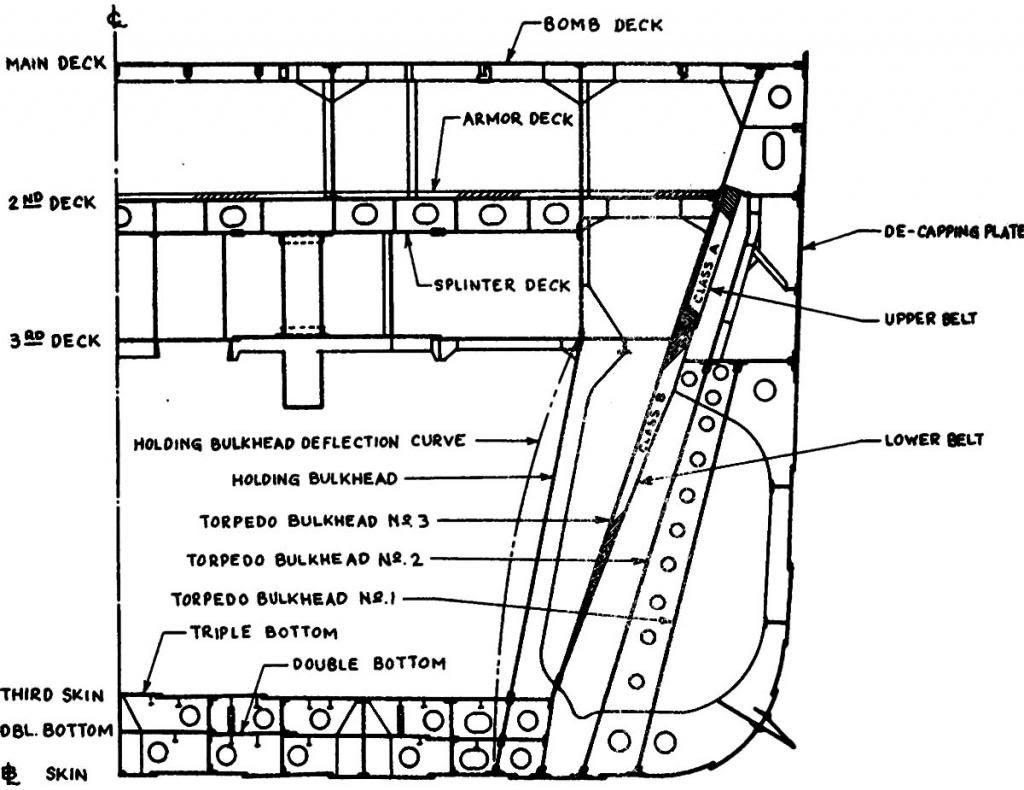

As you can see from the following cross-section, the armor is multi-layered and actually designed to stop spalling (slintering).

SpudmanWP said:
I see two problems with using HESH:
1. Battleship armor is layered which would inhibit the shock wave effect. Any spalling would likely be between armor layers and would therefore be ineffective.
2. Ships are compartmentalized and any spalling that did get through would have difficulty penetrating to sensitive areas and areas like the magazines have their own armor layers.
The natural and designed in layering of a multi deck, multi compartment warship would not be so effective against a ship sized charge of a HESH warhead. The armouring of a battleship is designed to defeat spalling from the armour created by impacts of kinetic penetrators. A HESH warhead of similar size would create far larger and far more energetic spalling. Many of these splinters may have the size and velocity to penetrate further inboard layers of armour to reach the protected areas of the magazine and propulsion units.

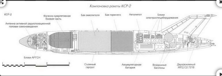

To be exact, they use combined high explosive/shaped charge warhead. A large HE with shaping cavity in front (pointing at downward angle). The idea was, that when missile hit enemy ship - usually from shallow dive - the jet would penetrate deep into the hull, affecting machinery, ammo magazines, command posts, while the blast wave and fragments would damage the upper hull and superstructure.
For example, the KSR-2 missile:

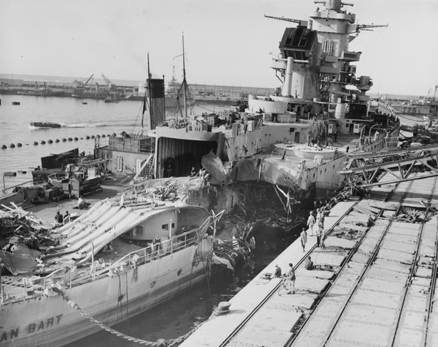

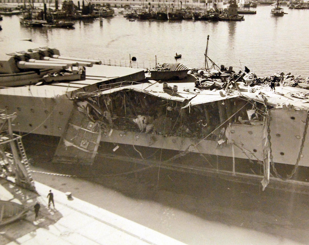

This is what a general purpose 1000 lbs. WW 2 era bomb could do to a ship.
In both cases, the bomb failed to penetrate any armored portion of the ship but pretty wrecked the bow and stern areas in a single hit. If the ship were at sea, massive flooding would have occurred due to wave action followed by progressive flooding as water entered the ship. So, I see no reason for a HESH round.
That's not from bombs. That's damage from the USS Massachusetts. This is the Jean Bart and photos after the Battle of Casablanca.
