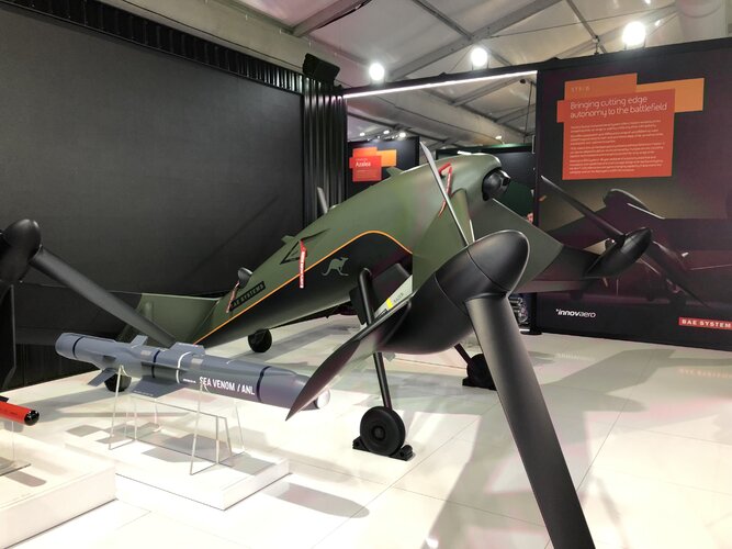

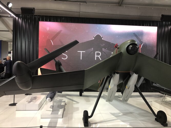

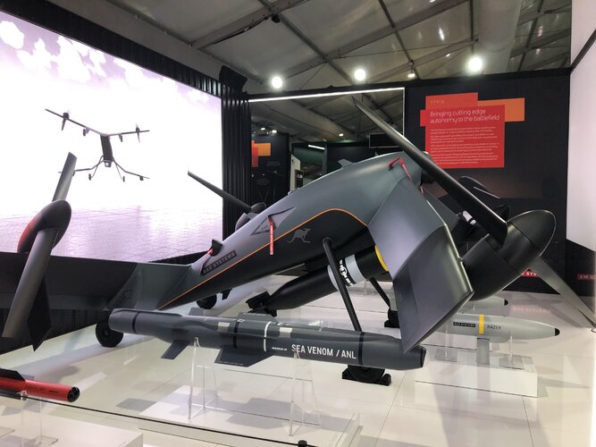

Btw, the blade tips of the front rotors are too close to the ground for my taste (3rd pic)...
  • strix-is-a-brand-new-military-vtol-but-it-kind-of-looks-like-a-wwii-fighter-plane_14.jpg

Easier to arm safely as well...it's also electric motors, but has a generator onboard. Not clear what type it is, if its a turbine, petrol or heavy fuel based engine, but that should give it a lot more range as well. Some of the marketing blurb gives a range of 800km with 2 of the Razer munitions onboard. Which is pretty good.

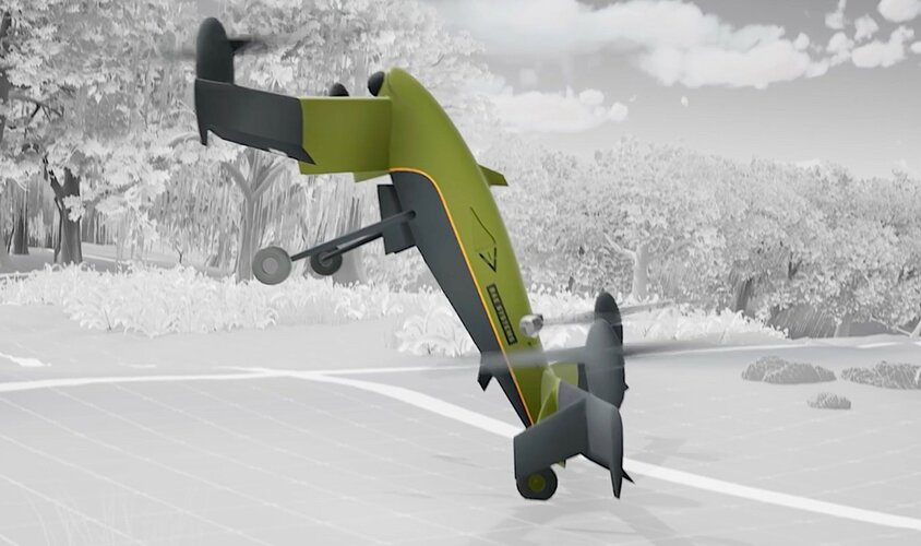

It's sad as I was thinking their original config was all about STOL (rolling). In front of wind, they also probably won't have to raise the nose at the vertical. A bit of pitch should ensure a near zero ground speed, only to be morated against gusts.

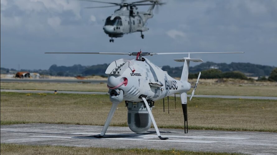

For the ASW mission in a seaway then the conventional helicopter wins out e.g. as per the UK PROTEUS. Lots of hover performance and resistance to gusts, stability on deck etc.
