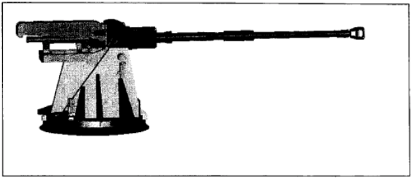

Single barrel (Generic Naval Turret): Automatic magazine designed for the Type 45, separate ammunition but a loading tray long enough to ram an extended range munition and propellent charge in one go. Weight was to be 26 tonnes.

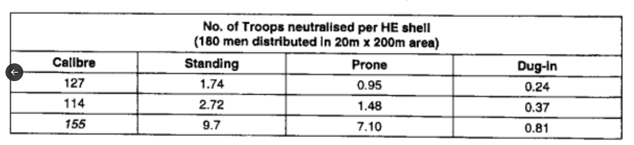

Quite interesting how much better the 4.5" shell performs compared to 5" in slide 7....a dramatic difference.
