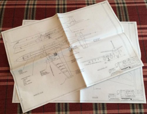

BAe Nimrod update drawings (Tay engined)
Re: Nimrod update drawings
Interesting, Nimrod meets Kawasaki P-1. B)
I can make out that the new engines were to be RR Tays, but nothing else. Any idea on the date for this project?
Looks like 1991 on one of the drawings. Auction ended, maybe somone on this forum won and can provide more info.
Wasn't me that grabbed it.
Tays, and the date appears to be 1991. Also has a four-wheel bogie undercarriage a la Vulcan/Shackleton Mk.4.
A friend of mine bought them so we have a good chance to see them here.
Drawings are titled "Nimrod Update", which is suggestive of what I've previously heard called the MR.2 Mid-Life Update. The avionics that went into the AP-3C were developed for this program, and eventually became the core of the MRA.4 and P-8 mission systems.

The undercarriage looks very interesting... if you look carefully you can just see the words 'Avro Vulcan type'...
BAe raiding the parts bin again...!
Zeb
Blow me, you're right! I couldn't quite make that out the first time.
In fairness, I doubt that actual Vulcan undercarriage units would fit. More likely, it was shorthand indicating that the new units would be of generally similar configuration and workings to the familiar Vulcan undercarriage.
