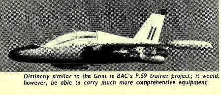

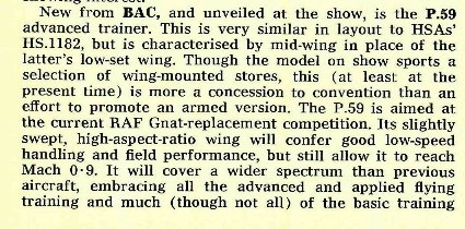

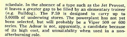

P.59 Unknown

Can anyone identify the following BAC Warton projects from the mid/late 60's (preferably with reference source):
P.48
P.50
P.52
P.56
P.58
