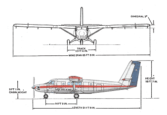

The BAC website is also long-gone but, from that site, is a front and side view of the Super Otter (attached). I'll cover the four main BAC concepts in separate posts.

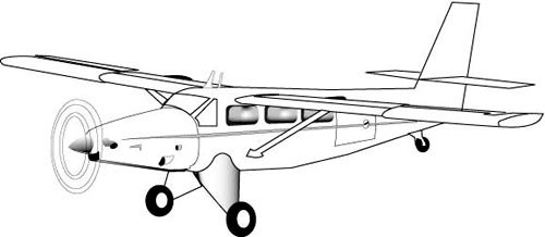

Beaver Aircraft Canada New-Generation Beaver
Stretched fuselage to increase cabin size (accommodation for 10 + pilot). Re-designed front windshield, digital cockpit instruments. Wider freight door.
Thicker chord wing with vortex generators to improve slow speed handling. Improved electric fowler flap system. Wet wing replaces DHC-2 fuselage fuel tanks. Larger wing will allow an increased gross weight up to 7,200 lbs on wheels (current 5,100 lbs). Empennage area also increased.
The landing gear strengthened to handle increased weight. Strut fairings improved to reduce drag (wing braces aerodynamically smoothed as well).
Engine to be the Pratt & Whitney Canada PT6A-20 or Walter M601E turboprop, or the 600hp Orenda Recip OE600A V-8.

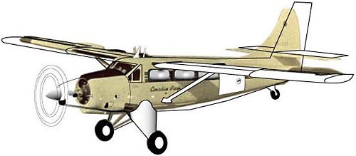

Beaver Aircraft Canada Next-Generation DeHavilland Turbo Otter
Turbo Otter would carry 16 + pilot VFR, 10 + pilot IFR. Gross weight - 10,000 lbs (2,000 lbs more than the current Turbo Otter conversions). Stretched fuselage with wider access door.
Re-designed similar to Next-Gen Beaver - new windshield, cockpit panel, stronger landing gear, an enlarged, thicker chord wet wing with electric flaps, smoother strut fairings. Probably vortex generators used to improve slow flight characteristics.
Pratt & Whitney Canada PT6A-135 or equivalent.

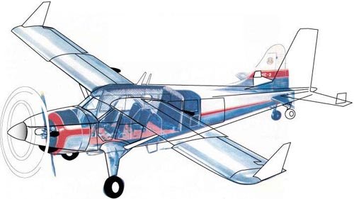

Beaver Aircraft Canada Next-Generation DeHavilland Super Otter
The Super Otter would have an enlarged airframe and Soloy Dual-Pac (the pdf lists this as a Twin-Pac, confusing the Soloy design with the PWC). The Dual-Pac makes the Super Otter a multi-engine type certifiable under FAA Part 23 Commuter regulations (IFR capable aircraft with 10-to-19 pax seats) up to 19,000 gross weight.
Super Otter would have a fixed tricycle landing gear and two PT6A-112s. The Super Otter
will likely be designed for a gross weight of 12,500 lbs and be slightly larger
than the DHC-6 Twin Otter.

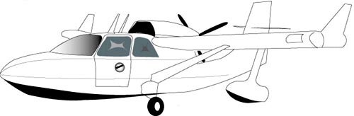

Beaver Aircraft Canada Tri-Gull
The Tri-Gull will be less familiar, so a bit of background ...
The Tri-Gull designer was Percival Hopkins Spencer whose earlier Air Car was produced as the Republic Seabee. The design was sold to Trident Aircraft Ltd. of Vancouver, BC for development (being originally known as the Trident Trigull-320).
Three prototypes were built (including one for static tests). I saw the first prototype being built in Richmond, BC by Canadian Aircraft Products (better known as a maker of aircraft float -- I'm not sure if CAP also built the other two). After an instrument check at Pacific Avionics, the first prototype flew at YVR in August 1973.
The plan was to produce the Tri-Gull at Patricia Bay airport (now Victoria International) but the project died in the recession of the mid-70s.
Somehow, BAC ended up with the rights to the Tri-Gull design. What BAC proposed to build looked quite different from the original Tri-Gull. The nose is reminescent of the 'Sea Hornet' PT6 Seabee conversion. The wings look like original Tri-Gull units but with winglets added.
Seabee News for 2003 has images of both the 'Sea Hornet' (scroll down to Nov 07) and the original Trigull in Viking's hangar (Jan 26), as well as a brief FI story (from 08 April 2003) on Beaver's efforts to establish production (Apr 14).
http://www.seabee.info/seabee_news_2003.htm
Few details of the BAC Tri-Gull were given. It was to accommodate 6 (including pilot) and be powered by Lycoming piston or Rolls Royce (Allison) RR250-17B turbine engine. The Lycoming was presumably a turbocharged, 350 hp TIO-540-J2BD since that engine was used in the prototypes (replacing the original Continental Tiara 6-320).
