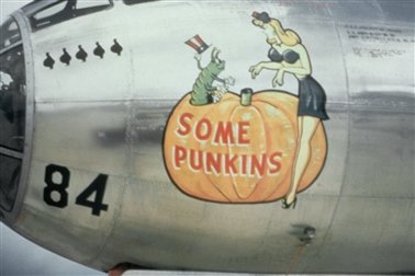

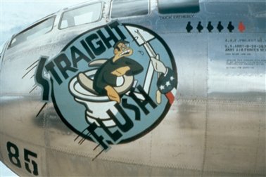

The Martin-built B-29s produced under the Silverplate program were the world's first atomic bombers. Straight Flush and Some Punkins were two of them.
So was Claude Eatherley's "85" that bombed the Imperial Palace Tokyo a stripped down atom bomber?
Numer "82" became Tibbets's Enola Gay, was the whole set of these Martin build B-29's all part of the non armed, stripped back versions that Col Paul Tibberts requested all for the 509th bomber group, or was it part of a bigger production run - where did the B-50 variations begin. Does anyone have a condensed history of where the B-50 variant came from, and where the different engine power plants arrived from. I'm interested in the craft from its use as the dropship for Yeager's X1. but I keep seeing korean marked B-29s with navy insignia along with late Douglas X craft drops using USAF marked B-29 or later engined models.

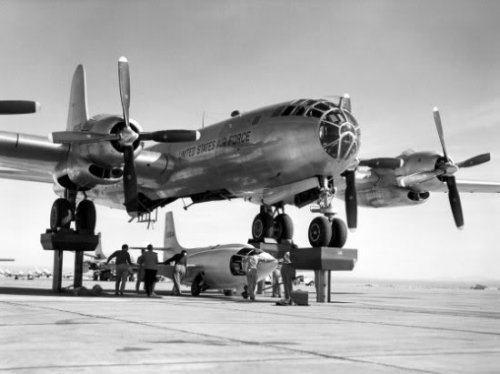

Any Info would help us resolve a 3d model for a B-29 mothership / Yeager X1 build.
Attached 2 shots with similar X craft but the different B-29s
Regards

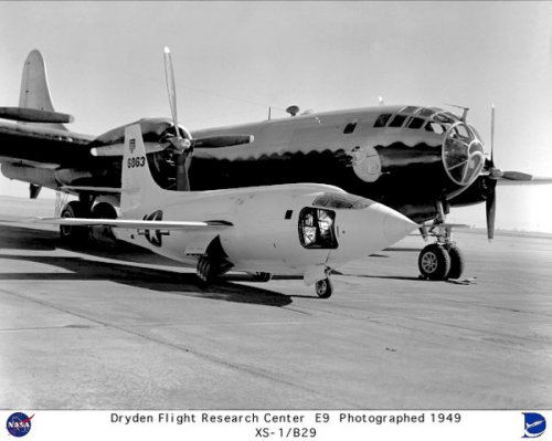

This was to be the other shot to compare with
