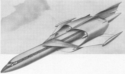

Non not all !
This design of the french engineer I.Labat looks remarkably different.
It's from 1958 and was credited with ultra-short take-off.
(from Luftfahrttechnik .7.58 )

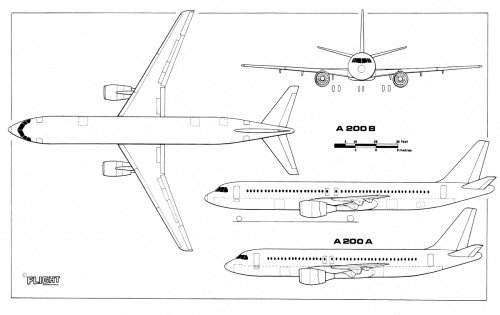

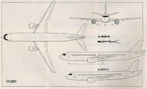

of course we know this project very well,but there are two variants,
A-200 A and A-200 B.
http://www.flightglobal.com/pdfarchive/view/1977/1977%20-%202120.html

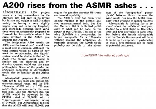

From FLIGHT International, 9 July 1977:

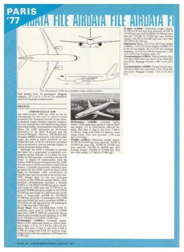

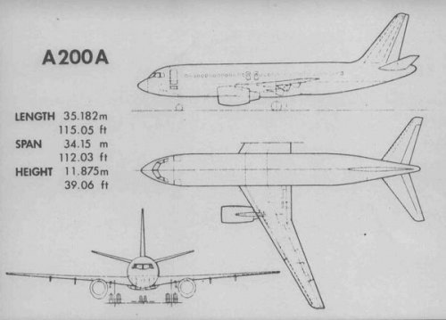

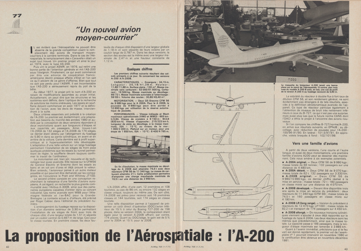

Dear Boys and Girls, here is an article describing the all-new (and non-derivative) Aérospatiale A200A & A200B "projects" for (then) new technology short-medium range jet airliners. The Aérospatiale A200s were not Airbus Industrie designs; they remained "projects" but over the next several years would contribute to and develop into (and through many permutations) the Airbus A320 family of jet airliners......
The article comes from the August 1977 issue of Air International......
Hesham, I think you should retitle this topic to "Aérospatiale A200A and A200B airliner projects".
Terry (Caravellarella)
  • Aérospatiale A200A project 3-view drawing - Air International - August 1977.......jpg
  • Aérospatiale A200A & A200B projects - Air International - August 1977.......jpg

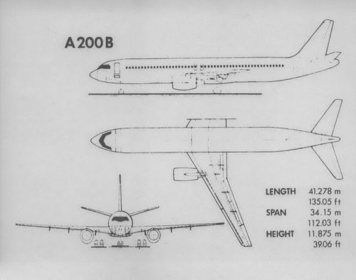

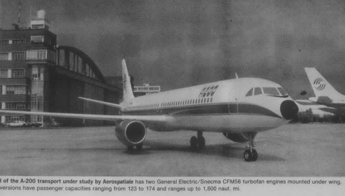

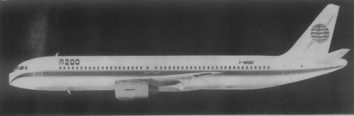

From Aviation Week .11.1977 a 3-view of the A-200B and two artist impressions:
