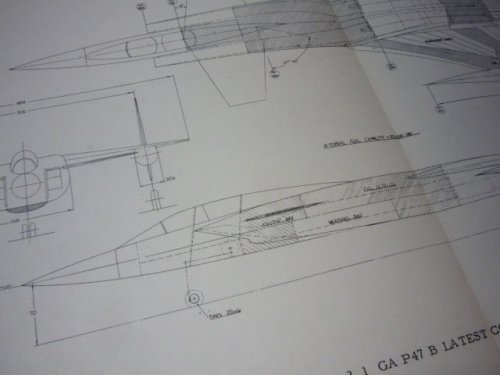

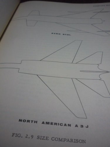

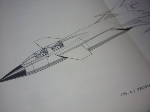

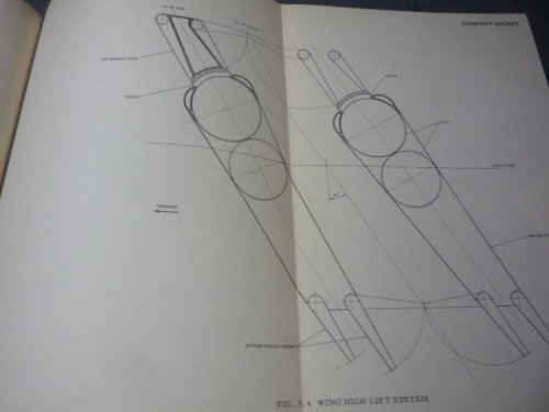

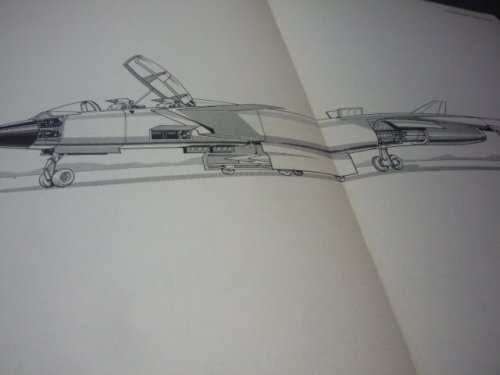

I just wanted to shed some light on the Avro P470.
The P 470 was never manufactured. It seemed to be the competition to the North American A 3 J as it is directly referenced in the design study.

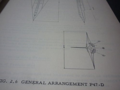

The P 470 was a STOL aircraft with 4 different configurations considered. They are referred to as the P47-A which is similar to the A3J . Second is the P47-B, The P47-C was 87'6" long This version was similar to the B, The P47-D was 84'9" long.

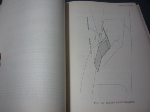

It appears the engine thrust could be directed from one engine into the wings to facilitate short takeoff.
Mach 2.4 at 60,000ft, 6,095 lbs thrust, 2.19 lbs/lb thrust/hr. is one of the performance ratings.
They had hoped to have the first one up in 1961.
Does anyone know anything about the General Electric MJ 259 engine? It was basically an improved version of their J79-9 design. i would like to know more about it....Thanks
