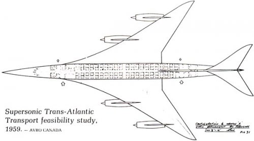

Attached is a plan-view of a 1959 Avro Canada supersonic transport study. (From Canadian Aircraft Since 1909 by K.M. Molson, ISBN: 0370300955.) This STAT (Supersonic Trans-Atlantic Transport) study was listed as configuration 6, a transatlantic design carrying 80 passengers.
A number of online sources link Avro Canada SST studies to the British HSA.1000 concept.
http://www.avroarrow.org/Jim%20Floyd/index.html
"After the Arrow cancellation Jim Floyd ... return[ed] to Britain to head the new Hawker Siddeley Advanced Projects Group. ... In December 1959 they submitted the first industry-sponsored Supersonic Transport (SST) design; the HSA.1000. This was actually based on work done at Avro Canada on an advanced SST and was derived in part from computer studies on optimal SST aerodynamics produced on Avro Canada's digital computer facilities."
There seems to be a host of problems here. I was under the impression that the HSA.1000 was the last submission to the STAC. Nor does the Avro Canada drawing much resemble the HSA project (of course, other Avro Canada concepts may have featured blended fuselages and nacelles mounted further aft.
Does anyone have any details about connections between Avro Canada and HSA SST concepts?

Anyone have any information on the performance figures expected for these SST designs? Also, what powerplants were planned?
