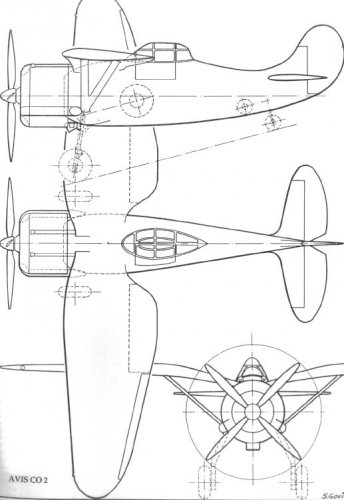

Like I've mentioned in another thread, this was one of the submission to the Regia Aeronautica Caccia-I (interceptor) competiton of 1938-39. It was immediately eliminated, along with the Breda Ba-100. In common with this, the Co-2 had the most powerful engine specified of all the submissions score to the competition, the Alfa Romeo 135 RC.32, a twin-row radial of 1350 HP. Span was 11,5 mt, length 7,50 and height 3,40. Max speed 515 Km/h at 3200 mts.

Not the best looking aeroplane.
Perhaps the offspring of a union between a boomerang and a Westland Lysander?
Wow! What an ugly aircraft... and it's Italian!
I don't believe that it could really fly 515 km/h...
Not really beautiful, but apart from the struts and the shoulder wing,
it's not that much different to other fighters with radial engines. In fact,
it looks a bit like a PZL P.11c with enclosed cockpit and retractable
landing gear. And the P.11c is said to have reached 390 km/h with an
engine not half as powerful as the Alfa Romeo 135 RC.32, so 515 km/h
may have been at least theoretically achievable

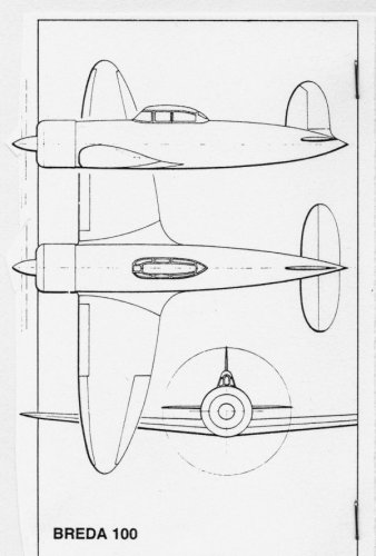

Beautiful or not, but is there any one who knows/has more about the Breda design, the Ba.100???
Thanks
That is a very odd cockpit. I wonder why it appears to be more streamlined at the front and less at the back? ???
Thanks for the drawing.
Are the further any details mentioned, such as: engine/armament/dimensions/etc.?
Data for Breda 100
Engine: 1 Alfa 135 RC-32 hp. 1.350
Span 11,50 m.; lenght 9,29 m.; height 3,30 m.
Empty weight 2.200 kg.; total weight 2.800 kg.
Max speed 580 km/h.; landing speed 116 km/h. (calculated)
Take-off in 200 m.; landing in 320 m.

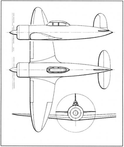

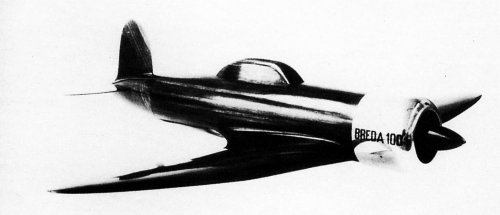

Breda Ba.100 from L+K
The Ba.100 was one competitor from 1939, others are Fiat G.52, AVIS C.O.2, Reggiane Re.2000, Macchi C.201, Caproni Ca.175 and Nardi F.N.530.
I search for drawings and technical data for the Caproni Ca.175 and Nardi F.N.530...
Thanks

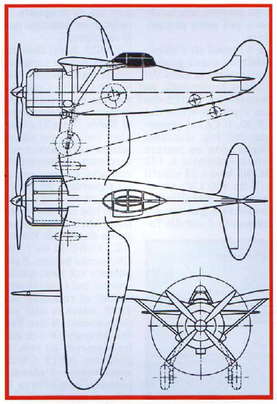

From Aerei Nella Storia 60,
a clearer drawing to it.
Yes, the cockpit canopy looks crude from the side, but if you look at it from above, it has a teardrop-shaped airfoil.
This pre-dates the NACA X-2 canopy installed on the single-seater version of the Turner T-40, amateur-built from plans, wooden airplane that was designed in the USA circa 1961. The prototype first flew in 1961, the same year that it won an "outstanding Design" award at the EAA Fly-In.
