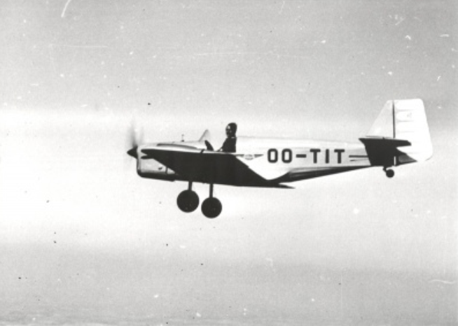

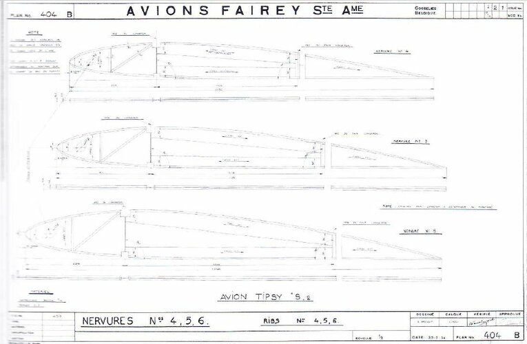

Does anyone have a source identifying the airfoil used in the wing of the Tipsy Junior light plane by Avions Fairey in 1947?
![EbtgrAWXgAAZ_AH.png](/proxy.php?image=https%3A%2F%2Fpbs.twimg.com%2Fmedia%2FEbtgrAWXgAAZ_AH.png&hash=d5a61debf14bfe2eb5dd5f5ca3e6baaa)
IF you can get a decent (square on) photo of the aerofoil, it can be imported into XFLR5, traced and then analysed. This is an imperfect process but but in the absence of other data, it may be your best bet...?
