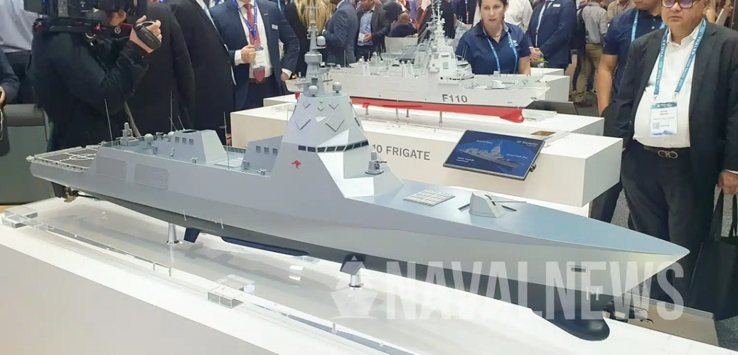

I will say that the Navantia Flight III destroyer seems appealing, though it lacks stand-alone ASCMs (maybe assuming the presence of LRASM-SL?)
HMAS Conehead looks pretty good, but what gun is that CIWS using? Barrels look inordinately long for Vulcan.
Sure it's not the Optimized Gun Barrel (99 calibers instead of 76, and much chunkier)?
The support frame around the barrels is much shorter on Block 1B with OGB, at least usually.
Better image here. Looks like it's the OGB (but not the normal Block 1B electro-optics). Also interesting to see 6 RWS mounts along the deck (looks like probably .50-cals) and five launch hatches on each side of the flight deck for drone swarms or counter-drone swarms.

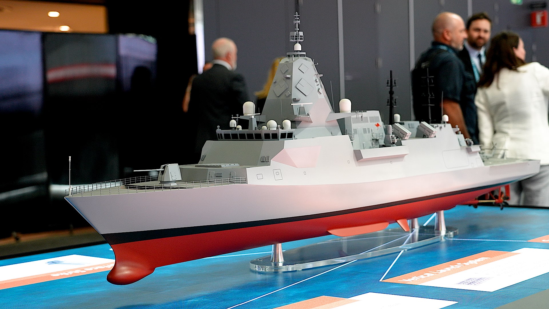

That Hunter batch two proposal with 96 VLS and AsHM increased from 8 to 16 with 5" maintained looks scary, its literally matching if not exceeding the firepower of a Tico class cruiser in something inflation adjusted is probably 1/3rd the price.
