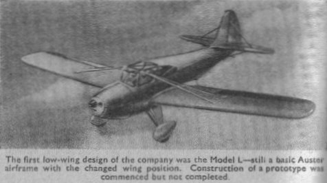

However, both the site and you have forgotten the Model L low wing monoplane, which was started though never completed (see attachment).

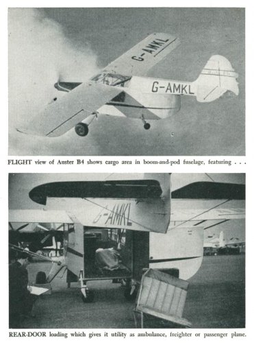

As there is no topic for assorted Auster designs, here is the B4:

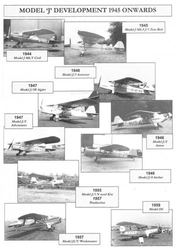

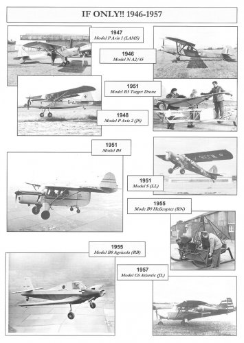

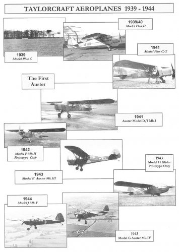

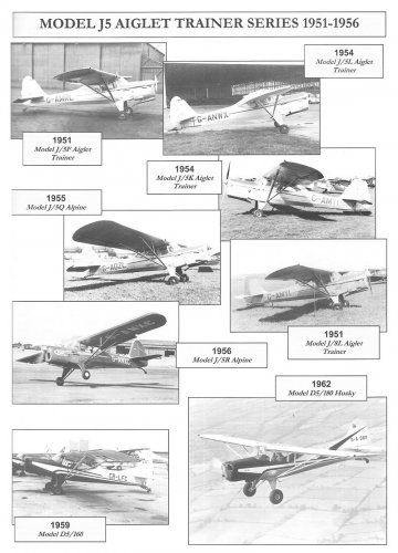

I was glad to find that there is still a handful of dedicated enthusiasts for vintage aircraft on our forum (I worry at times that it seems to have become a news-oriented forum...)
So for all of you who can appreciate that kind of stuff, here's from the excellent book Austers: A design & anecdotal history by the Rearsby planemakers, published by the International Auster Club Heritage Group in 2002.
