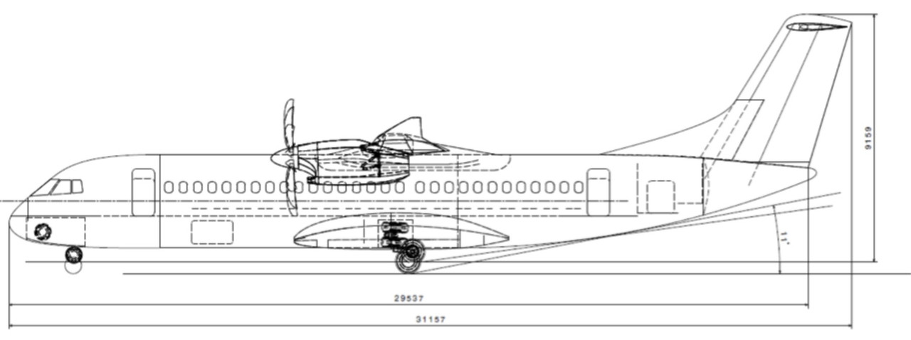

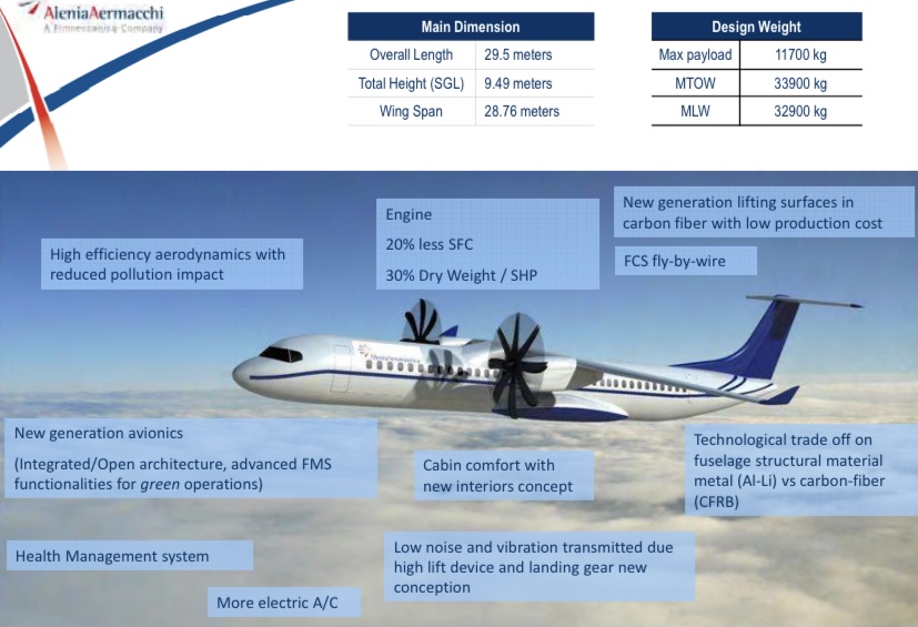

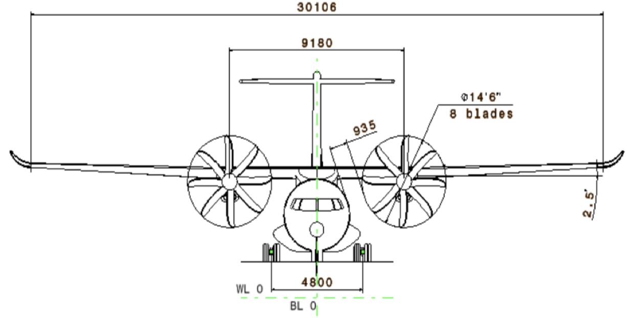

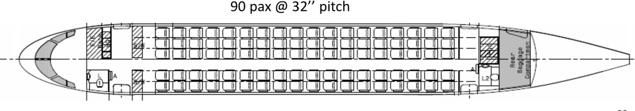

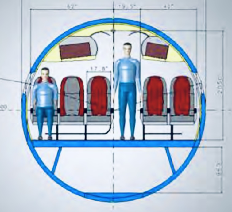

I recently found new info on Alenia/Leonardo’s research on a 90 seat turboprop, under the EU-funded Clean Sky I/II program. Posting it here as I think it relates closely to the ATR 92... nice to finally have more detailed specs!
Seems like it would be an amazing aircraft if only Airbus would let it happen.
Green Regional Aircraft (2010-2012): CleanSky I studies
Initial specs:
The ~16m long cabin can fit 90-95 pax in 5-abreast seating at 32” pitch (length between cabin doors). Total cabin length is ~21.3m.
The cabin is roughly 2.5-3m longer than an ATR-72 (13.6m between cabin doors, 18m total cabin length).
In higher density configurations this should fit ~100 pax at 30” pitch or a maximum of ~110 pax at 28” pitch. This is almost exactly halfway between the ATR-72 (68-78 pax) and the smallest Airbus A220-100 (120-135 pax).
The ~3.45m wide cabin is almost identical to an A220 (CSeries)... maybe 1-2 inches narrower.
In terms of performance, max speed of 337 KTAS is ~23kts slower than a Q400.
The design range with 95 pax (10 ton payload) is 1,000nm, similar to a Q400 with 74 pax (7.5 ton payload) and better than an ATR-72 which can only do ~700nm with 68 pax (7 ton payload). This should be plenty of range for the typical 300nm sector.
Good stuff! And definitively an outgrowth of the ATR 92. For those who don't know, the European Commission's Green Regional Aircraft (GRA) programme is part of the larger Clean Sky program. GRA was led by Alenia Aermacchi and EADS CASA - 'GRA Relevant Project Leaders' in EC-speak - but is now under Leonardo Aircraft Division and Airbus D&S.
Alenia dubbed this ATR evolution as their TP90 (which is used in some Clean Sky documents too). Within the Clean Sky programme, this design was more often referred to as the GRA 90 Turboprop - to distinguish it from the related GRA 130 Geared Turbofan. The GRA 90 is also called New Turboprop (NTP) configuration (at least in its 5-abreast fuselage format). Loosely, it was just referred to as the 'Green Turboprop'.
By 2014, the proposed layouts had been narrowed down. The GRA 90 final configuration was essentially as you've shown, powered by twin underwing Snecma or Rolls Royce engines. The GRA 130 was finalized in the rear-engined configuration powered by two MTU geared turbofans - the Advanced Turbofan and Open Fan options having been abandoned.
Circa 2014, design of the Green Regional Aircraft Fuselage Barrel and Wing Box demonstrators was finalized. A 'Full Composite Cockpit' section was later added to that list.

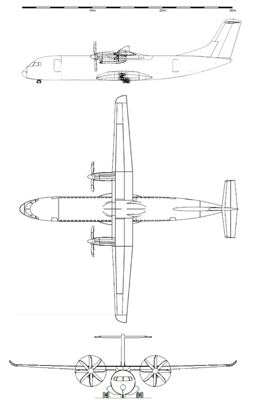

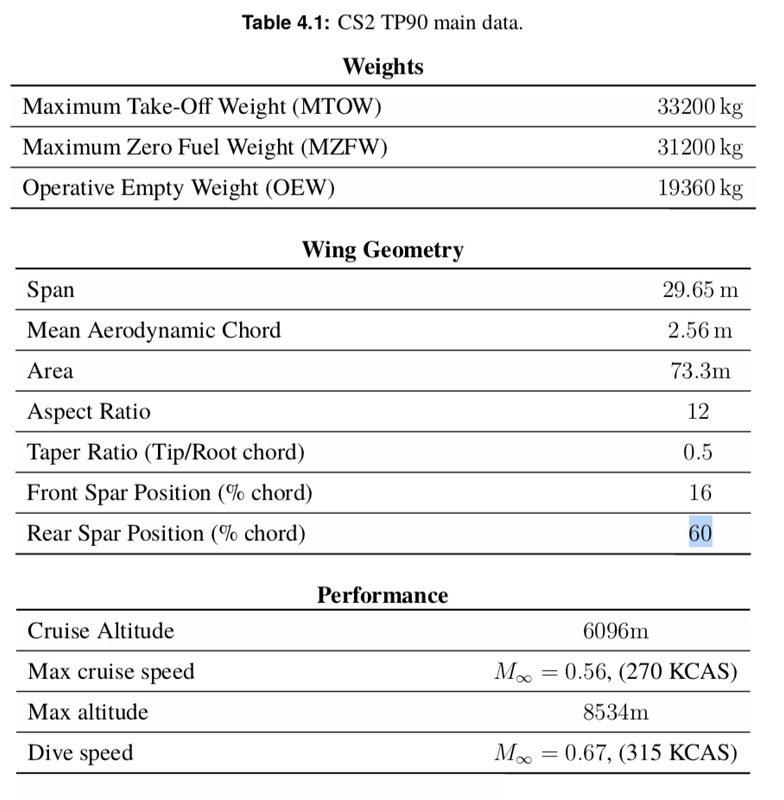

Related to the above, here’s the 2nd set of info I found on the TP 90.
This is more recent research from the Clean Sky 2 program, called Regional Integrated Aircraft Development Platform (REG-IADP). Specifically Work Package 2.1.2 on Morphing wing structures:
Note: Top view doesn’t look like it’s correctly to scale.
MTOW is now 700kg lighter, cabin dimensions essentially unchanged but the overall length and span are slightly larger with new wingtips.

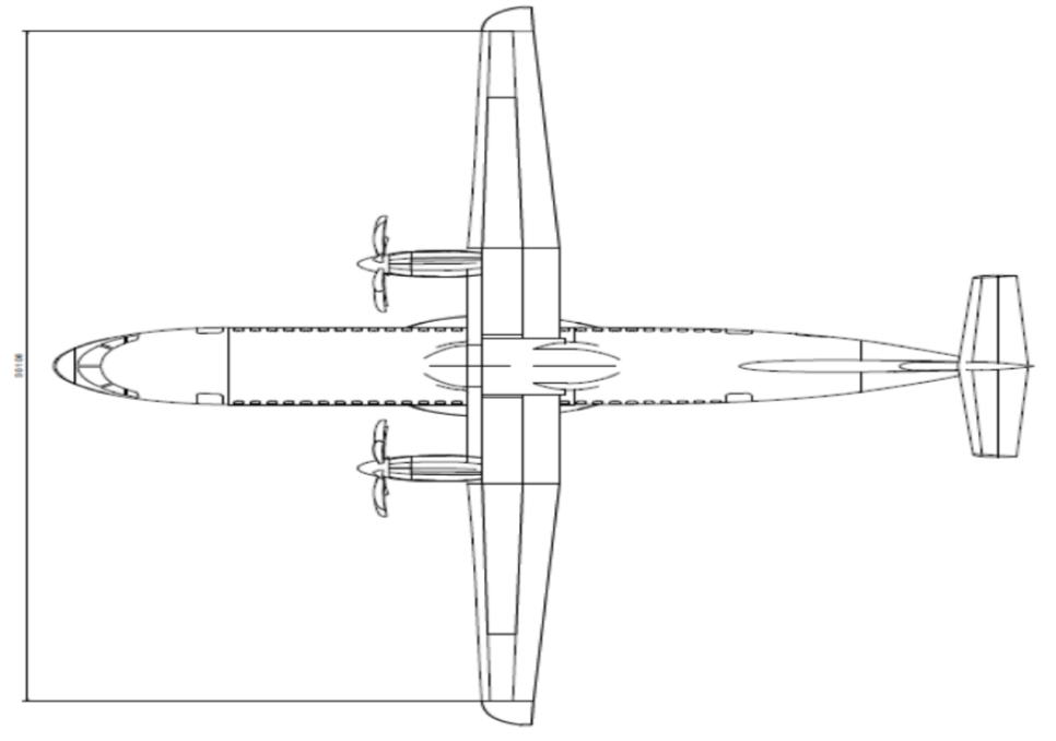

This is my attempt to show the above drawings to the correct scale:
(Note I removed the windows because I was curious about potential freighter and military transport applications to replace the C295, C-27J Spartan and C160 Transall - which would require the addition of a ramp... this would potentially fit an interesting niche with savings from commonality with a civilian variant which would help the business case to launch it).
