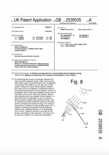

Hi. Contextual info.
Nick Colossimo, patent author, lectured here:
https://live.newscientist.com/nick-colosimo/
A.
Hi.
BAE SYSTEMS's Atmospheric Lens patent found!
33 page long! Happy reading. :)
A.
