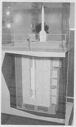

Since it is most usually associated with ASTER, a nugget on the early development of the SYLVER launcher, then simply known as "SLV". An 8 cell module actually contained 12 cells, two being used for the unusual end-mounted exhaust plenum. Dimensions per module were 3.81m long, 1.52m wide and 4.5-5.5m high depending on type. Empty weight 6t. It was hoped to be adaptable to Crotale, Seawolf,Standard and SSMs.
Reference: 1984 French Naval Exhibition, IDR 1/1985

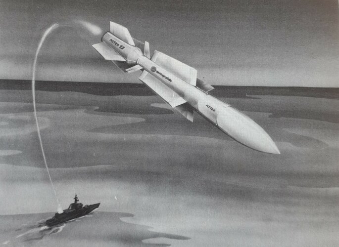

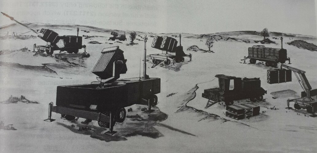

An early artist's impression of the ASTER 15 and an early (circa 1985) impression of a SAMP battery with the SA 90 ramjet powered missile and an early design for the Arabel radar.
